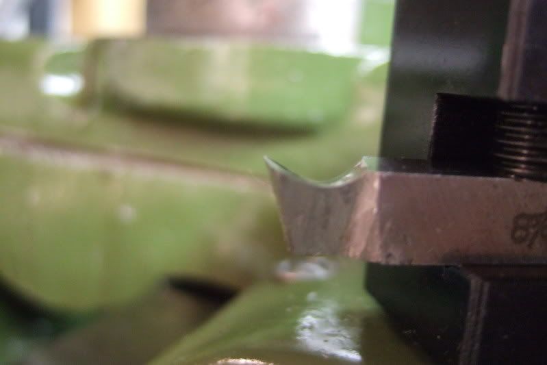

              I decided to give it one more try beforedis-mounting the mandrel.
              I found this cutter in my drawer;
              Gave it a quick hone with a diamond paddle, and it cut very clean with
              the part mounted just as it was before but NO chatter!
