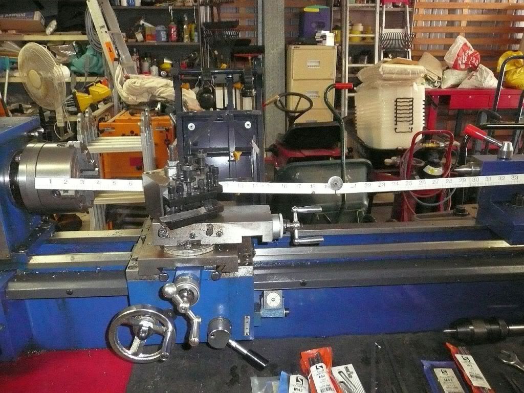

                      Here is my B227L lathe - about 28+" between centres:
