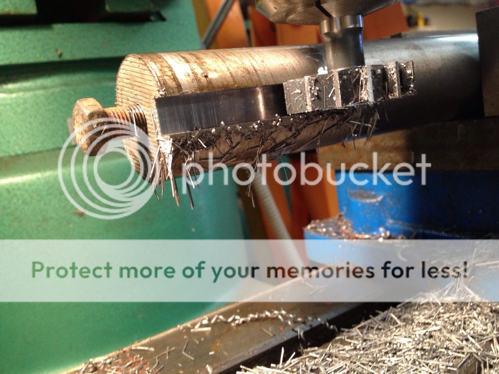

    I have a steel 4 groove pulley that is 3.2" wide with a bore of 38 mm (1.496") with a 10 mm keyway. I have 14x40 lathe, bridgeport style mill, a 5 ton Dake style press, a 20 hydraulic press, and a # 20 Dumont broach set. I need to fit this pulley to the end of a 1.5" shaft for a rock crusher. Given the choice would you bore and rebroach a new key way in the pulley or turn down the end of the 20" long shaft and cut a keyway for it? Why? Do you think its possible to broach a pulley 3 1/4 wide with my broach set and presses?

          Given the choice of pulling the shaft from a rock crusher or boring 4 thou from the pulley... lol... bore the pulley! Even if it's out of the machine, I'd still bore the pullley and leave the machine shaft "stock".
          Broaching... depends on the broach size you need, but you might not need to - you can just make a stepped key to adapt the existing pulley keyway to the crusher shaft.

              After much perseverating and a short vacation I just went ahead and did it. Put the shaft in the 4 jaw and centered it. Fortunately the lathe spindle can take 1.5". Skimmed it down to 38mm. Then put it on the mill and using a 3/8 keyway cutter did the first pass and then lowered the table an additional .0187" so the keyway would be 10mm wide. That way did not need to make a stepped key. Like lakeside said 1/2 hour. Just had to over think it for 2 hours though. Hardest thing turned out to be the metric-English conversions.

                        That would result in the center line of the KW being off center by over .009". Did you notice any trouble getting the key in when you fitted the shaft and pulley together?
