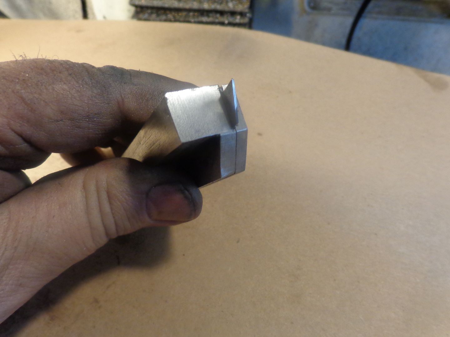

    My Grandma was right!! Idle hands are the Devils workshop!!! This week, I've been pretty darned idle. To the point where I have started building those tools that you only need "Once in a blue moon!!" I occasionally have to put snap ring grooves in small shafts, ranging from 3/16" up to 3/8". Up until now, I have "made do" by clamping a hacksaw blade to my toolpost in the lathe. Yesterday afternoon, I designed one which will fit into my AXA toolholder, which is a lot more secure and a lot safer. Hacksaw blades seem to be just the right width for this. I know I could have ground down an HSS toolbit and accomplished the same thing, however I have a lifetime supply of hacksaw blades so thought I would do it this way. Note that on the drawing there are a couple of dimensions with ### or *** after them. They are to remind you to measure your own hacksaw blade to use in this rig. My hacksaw blades are .027" thick x 0.458" wide--yours might be different.

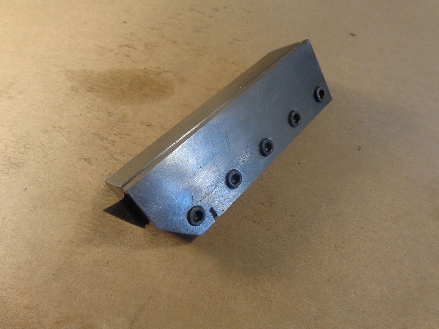

    #2
    These are the parts disassembled. The cut in the cover plate isn't supposed to be there. I was using up some stock that I had, and that little cut doesn't impair the way the tool works.

        #4
        And here we are, all assembled.

              Do such blades need to be ground slightly on the side surfaces to make a trapezoidal cross section and avoid jamming? It may not make much difference for shallow cuts for snap-ring grooves, but for parting I think it might be necessary.
              USA Maryland 21030
              • brian Rupnow
                • Mar 2008
                • 12915
                #8
                At first I tried the hacksaw blade with no top-rake, like I would normally use for aluminum, but it didn't want to "bite" into the cold rolled steel. Then I ground a 10 degree +/- top rake on the top of the hacksaw blade, and it started curling out chips like nobody's business. I wouldn't dare use this for a cut-off, but it certainly has no problems going in deep enough for a snap ring groove.---Brian
                    RE: The small cut. Maybe too late now, but you could do like the software companies do in How Many Software Managers Does It Take to Change a Lightbulb? Highlight the cut and call it a feature of the tool.
