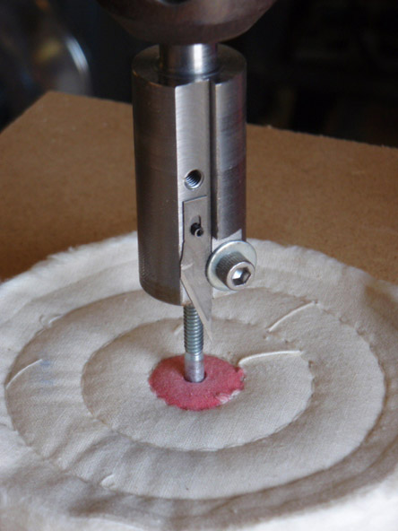

Later, after I bought a Baldor buffer with a 3/4" arbor, I needed a way to open the bore on these. I came up with this:
Sweet. I need to make some gaskets for a hydraulic cylinder that doesn't use orings but instead uses end gaskets.
Thank you sir!.
