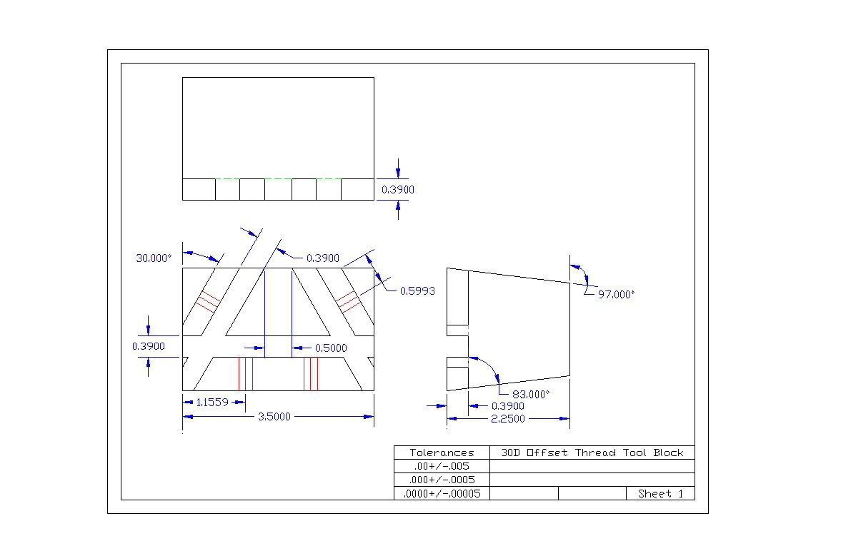

    The problem I find with most carbide inserts for threading on manual lathes is the SFM usually cannot be kept at a high enough speed to get a decent surface finish in the threads due to the faster reaction times. Hence on manual machines I still use HSS threading tools. With one exception and that is on a Hardinge Tool Room Lathe but that is a special case. But I cheat on my threading tools. I form grind them on a surface grinder
    And for custom tooling and angles I use this
    It can be set to any angle need and automatically adds in the side clearance. I used to have to grind my tools free hand when I was an apprentice and I think apprentices still should learn how to do it. But once you know how to offhand grind tools then the use of special fixtures a very good idea IMO.

    Kap, that's because ahem, Great Minds Tend to Think Alike, (ducks from slings and arrows here)
    I actually have another design that I'll post over at photobucket one of these days. Haven't made it yet but I do have all the details worked out in my head, and now in CAD
