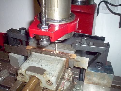

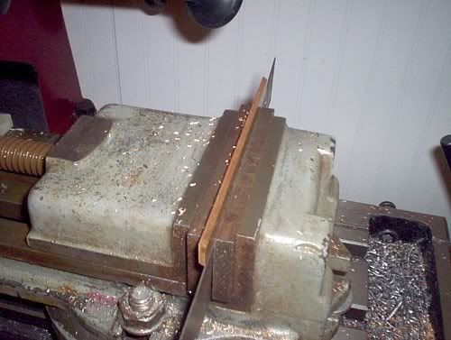

    Here is the what I went thru to make my new jib.
    This was the set up that led to the oil bottle.
    Set up to cut the screw pockets parallel to the bevels... the jib screws have a flat face.
    The old wonky one and the new brass one.

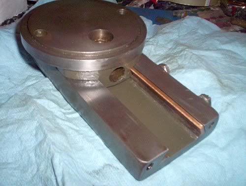

    Here's the fit up.
    Not a bad fit.. slides nice and smooth.

    Furnace you should be able to use the same set up as I did. The jib was a bit over 5" long. I use a piece of tool steel as a parallel and to support the overhang. Tilted the head over and used the table to feed the strip into the cutter. If you have a gearhead mill I'd recommend looking at the gearhead mill tips I posted... will save you a mess. For the 7" length you could use two pieces of 7" x 1 1/2" x 3/8" flat bar as jaw extensions.

    I guess I missed the part about it being cracked. When I read another poster comment that his was also bowed I got the idea of lapping it. Your current configuration seems like it be a bit testy to work with and give no way to lock up the jib/gib or adjust on the fly. If you wanted the brass/bronze wear strip you might be able to pin a 1/8" or so thick piece to the face with brass rod. That way if and when you need to replace you'd only have to re face it with new piece of brass/bronze instead of remake the whole thing.
