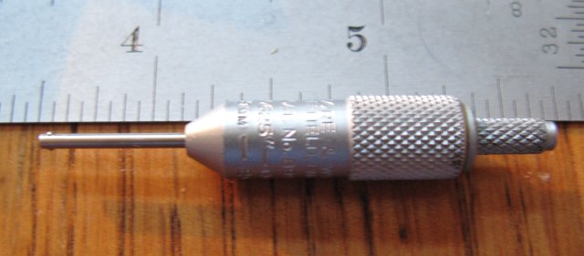

    There is a type of gage for holes smaller than the normal ball end gage will measure:
    This is one from a set by Moore & Wright (I've seen them in the SPI catalog as well) and is intended to allow measuring holes from .0625 to .080, the rest of the set extends the range to the bottom end of the ball end gages. These are similar in that there are balls and a tapered pin that drives them apart to engage the sides of the hole. It takes a pretty delicate feel with these little guys.
