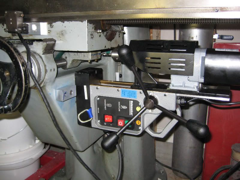

    But not all the previous holes were in the right places for the Jenix scales, so I used a magnetic drill press to drill the holes perpendicular. This is a Jancy Holemaker -- 30 lbs, with a coolant system, very nice unit:
    This was the first time I'd used a magnetic drill press. It's a little tricky to get the 30lbs slung into an awkward position before you trigger the electromagnet. But like the electromagnet on a surface grinder, it takes a couple of second to de-energize, so what I found that works is sticking it in the general vicinity of where you want to drill, then turn off the electromagnet, nudge it closer to where you need it before it falls off, and quickly turn the electromagnet back on.

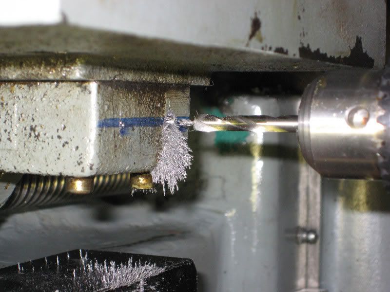

    Of course, that magnetizes any metal objects within 4" or so of the electromagnet, including the cast iron dust from the hole you're drilling:

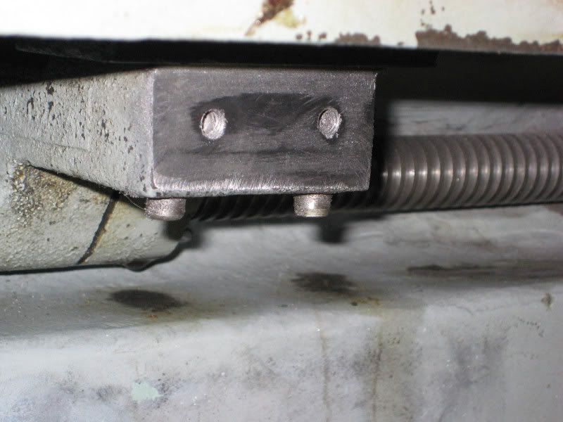

    On a Bridgeport, you normally mount the Y-axis reader head bracket on the saddle. But on the Mllrite, the saddle has a cut-out where the Y axis leadscrew and nut carrier run on the side. So mounting the reader head like a Bridgeport would have required a plate to go lengthwise, then down, and then an angle piece back in to the plane of the scale/reader head.
    Mounting the reader head bracket on the nut carrier bar itself would be a lot cleaner, but it's roughly cast iron. Drilling it for the mounting holes was miserable, so I knew that milling the end flat (so the reader head would sit flat), was going to be a problem:
    I pulled out a hand scraper, and even with a freshly sharpened carbide blade, it just skipped off the hard casting skin. Even my Biax (power scraper) just ricocheted off it. I thought about using an angle grinder to take off the skin (I know, I know...), and then decided to try something dangerous and stupid: I mounted a 3/8" carbide endmill in the magnetic drill press, mounted the drill press sideways on the knee, and gently skimmed off a couple of tenths at a time by feeding the table in:
    After a bunch of passes, I had the nut carrier block cleaned up very nicely:
    Which made installing the reader header bracket a breeze:
