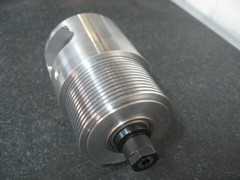

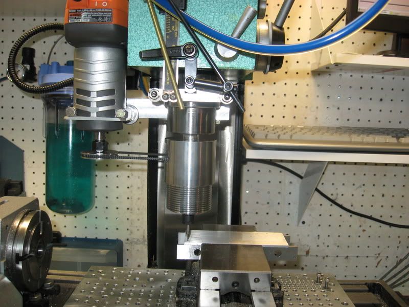

    I made this high speed spindle setup for my x3 mill. It uses a Rigid trim router for power. The cartridge spindle is made from stub er11 chuck. There are 3 bearings in the cartridge. Finned for heat dissipation. A 3mm polyflex belt is used. It'll turn near 44,000rpm.
    The spindle on the mill is clamped stationary and the high speed spindle fitted into a 3/4" r8 collet..
    Here's the setup-

    Excellent pictures! what bearings did you use? Precision tapered bearings, or deep groove balls, or a combintaion? I assume the cartridge is aluminum?

    Jason, yes just deep grooves cleared of grease and using light oil. 2 bearings at the nose pressed on and one floating fit in the rear.
    Static runout 1" out from the er11 spindle is .0002". The 7 er11 Collets range from .030"- .250".
    It'll run about 30mins before it begins to heat up at max rpm. Some sort of cooling system would be needed for extended running times.
    The rigid trim router costs 100$ and has a lifetime warranty so if it ever burns out just go and get a new one. Nice powerful 6amp universal motor with soft start and variable speed-

    It's a powerful little spindle. I've also used it on the lathe as an internal TPG.
    It's all aluminum except for the spindle which was made from a USA Craftsman brand er11 steel chuck.-http://www.use-enco.com/CGI/INSRIT?P...PMPXNO=8708664
