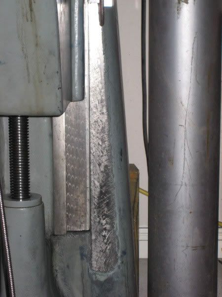

    Edit:
    This picture shows the first round of scraping of a new piece of Durabar and one of the scrapers I bought at the scraping class in Newport, Oregon. Notice a few things.
    - Itty bitty strokes of inconsistent length and scour depth
    - Cat claw scratches from the tool
    - Chatter marks perpendicular to the cat claw scratches
    - There is nothing consistent about tool placement and usage. I was doodling.
    - At this particular moment my back did not hurt but would soon as my posture was bad
    http://thevirtualbarandgrill.com/mac...g/DSC01241.JPG
