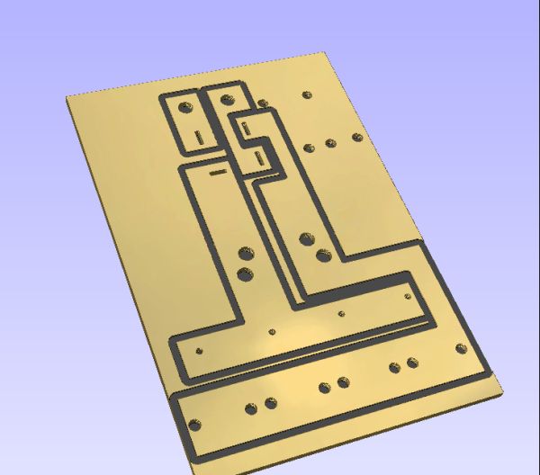

    Not seen them around for a bit, I did look a while ago as I could have used one.
    Finished up milling some of these out of thin brass sheet bonded to phenolic board.
    made for two different size caps by the holes the middle strips. The holes in the bottom take four fuse holders, slots are for the bridge rectifier and the other odd holes are for terminal strips.
    The spare brass is peeled away after cutting.

    Thanks for that John,probably what I will end up doing.
    I can't for the life of me remember where I saw them.It wasn't long ago and they were like $20 including the rectifier and terminals all done up,just add cap and transformer.Seems like they were capable of 15amps @72VDC.
