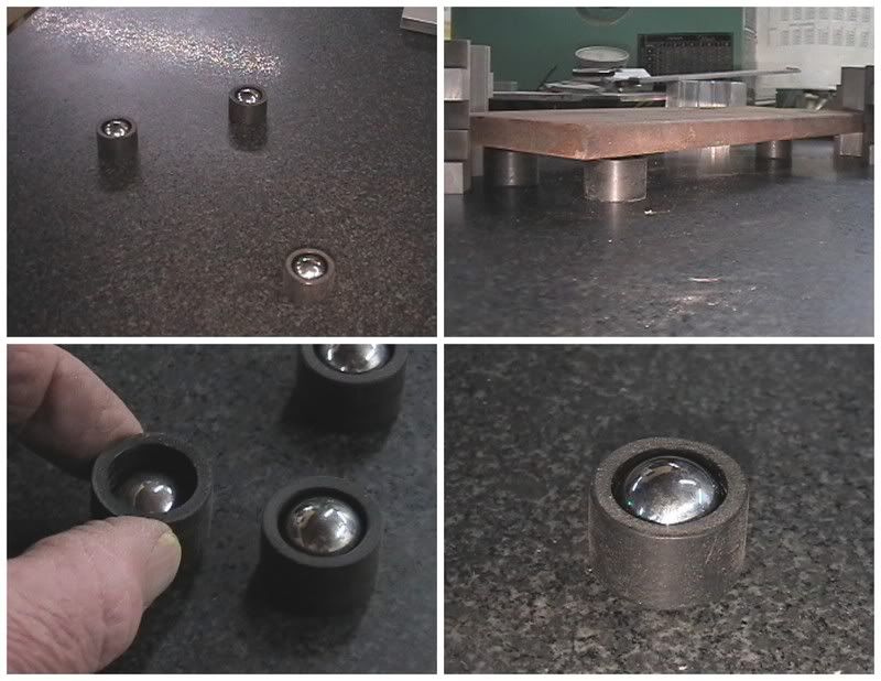

    Default 3 Point plane by 3 ballglides.
    Quote Originally Posted by Neil Jones
    I've been using the corners of three 1-2-3 blocks set on my surface plate to check the angle plate I'm trying to grind flat and square. I tried to use 3 jack stands that have points but the adjustment is too coarse. What do others use to check for flatness?

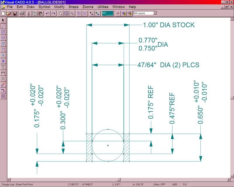

    Some thing along these lines may help.
    Plane established with three 0.7500" dia balls.
    Sleeves made of 1" dia delrin, snap over ball, to keep from rolling too much on table.
    Vee blocks keep stock from rolling around.

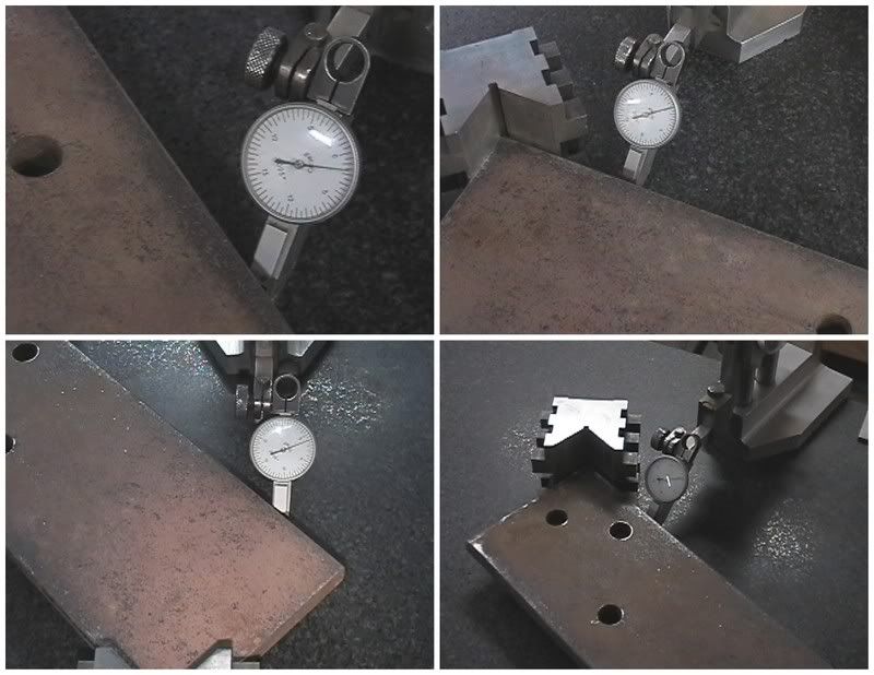

    As you are grinding angle plates, Blue the surface?
    Les H.

    Yes, because I'm looking for just a small point of contact in three places.
    Heh, 'use ball bearings' was a drop-dead obvious answer.
    Less obvious was putting them in those little sleeves, which is clever.
  8. #8
    Mar 2005
    9,394
    You can drop them into a washer, too. So long as they don't roll away while you're using them any retainer will work. But I really like the plastic tubes.
