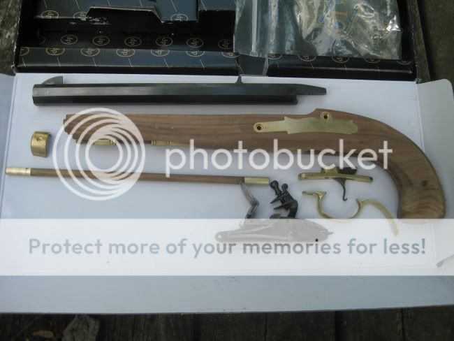

    We filed the inlaid brass side plate today so it is flush with the stock. It had been pressed in so hard we couldn't get it off - there was nothing to grab it by.
    We draw-filed it with a fine cut file - now it is ready for steel wool.

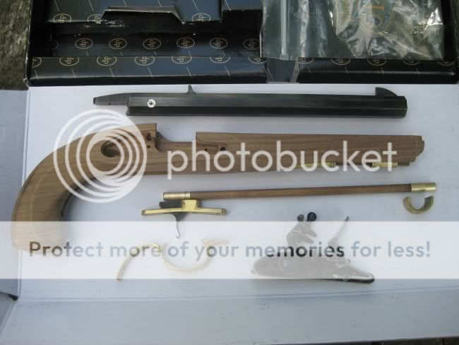

    It's still apart and unfinished. Right now he's contemplating the finish. A period firearm would have been varnished I'm sure. Maybe we'll use a surface finish. He says he doesn't want it shiny. Given this pistol will never be in a museum, it could be a matt polyurethane is best as it is impervious and easy.
    The next part of the project is to figure out how to buff the 'thimbles,' Which are the cast brass widgets that the ramrod slides into for storage. Their shape is not file friendly. We don't have a buffing wheel.
    The barrel has tool marks in it. They don't make the gun less functional. I am not sure if he's going to remove the sights and file the barrel. I would, but I'm anal that way. The sights seem to be slid into dovetails. I don't know what's holding them in unless it is friction.

    Here are some pics. We're putting an oil finish on it now. I think he's going to follow it with polyurethane. Aw c'mon, if the ancients had had it, they would have loved it.

    You may want to re-think poly over oil. Most of the time you won't get a good bond between the two, and may get peeling.
    Flint era pistols have been observed in brown, blue or in the white, polished. All are original finishes, though the brown and blue used would have been rust brown, or rust brown boiled to convert the surface to a hard black. You're best off not polishing past 400 grit on the steel if you'll be using any of the cold blues or heat activated browns. Too bright a surface, and the blue will not wear well, and the brown may not take.
