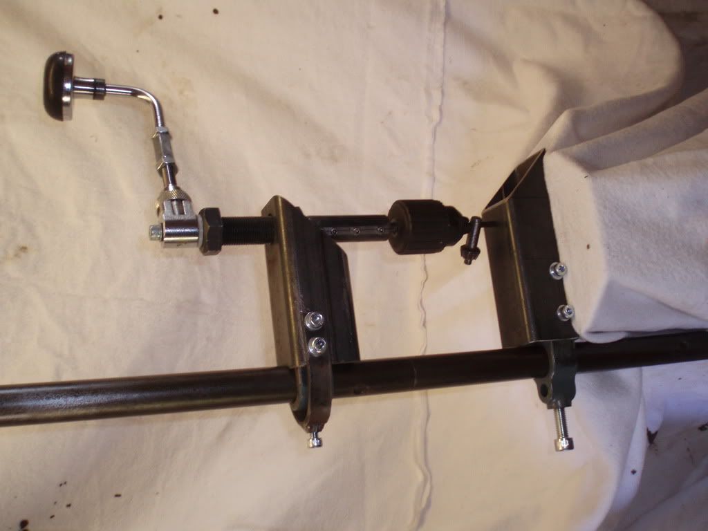

    Sorry guys this has been a long time coming but I have nearly finished this project.
    As promised some work in progress photos.
    First though I have to acknowledge a huge debt of gratitude to Ross Walker who posts on here as RW. Ross very kindly sent from Oz a set of measured drawings, photos and card templates of his own Cole drill. Really beyond the call of duty and I can't say how much I appreciated the gesture.
    At the end of the day design and construction was dictated by the materials at hand.

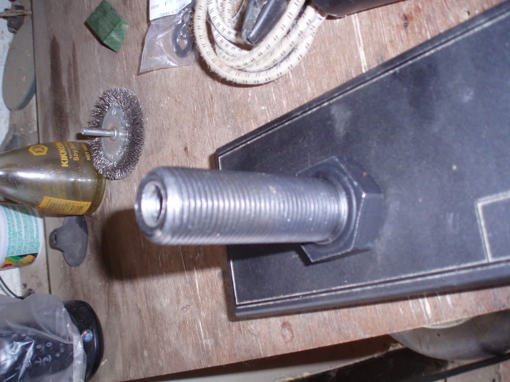

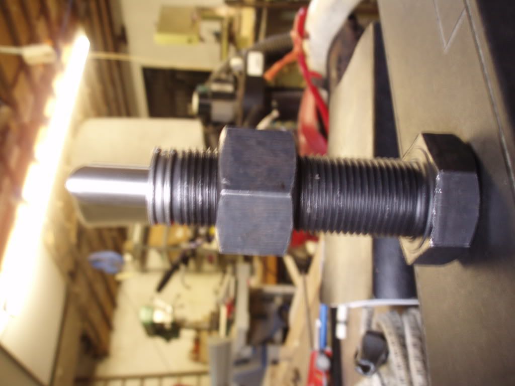

    First problem was the bolt. I managed to find at a local motor factors a 1" UNF x 3”
    I drilled and reamed a ˝” hole through this and purchased a suitable thrust washer from an online bearing supplier.

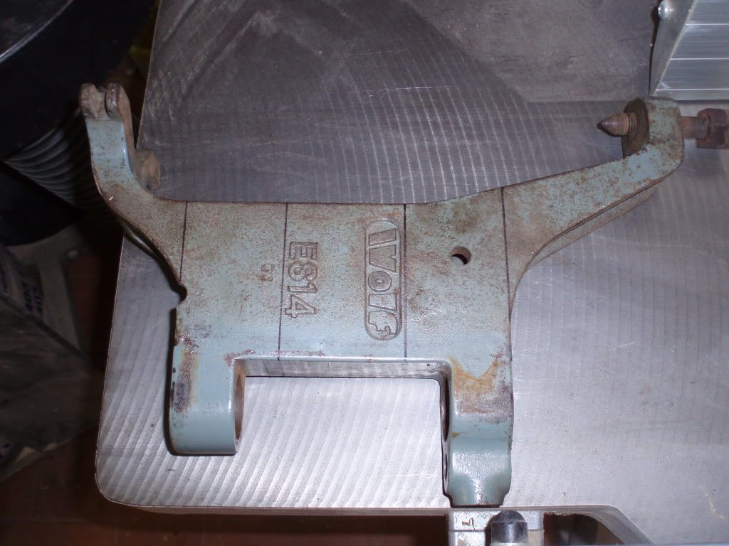

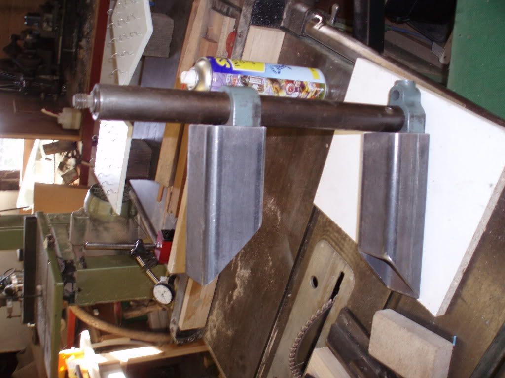

    Raking around in my spares department I unearthed a casting from an old DIY type pillar drill stand. This was cut up to produce the brackets for the base and head of the drill. The castings were bored for 1.25” round bar and looking around the workshop I realised that the guide rails for my woodworking table saw were 1.25”. I had a pile of extension bars for the saw that only see occasional service so these would do very well for the drill pillar, with the added bonus that they can be screwed together to give an extension if required.
  8. #8
    Aug 2006
    West Sussex UK
    210

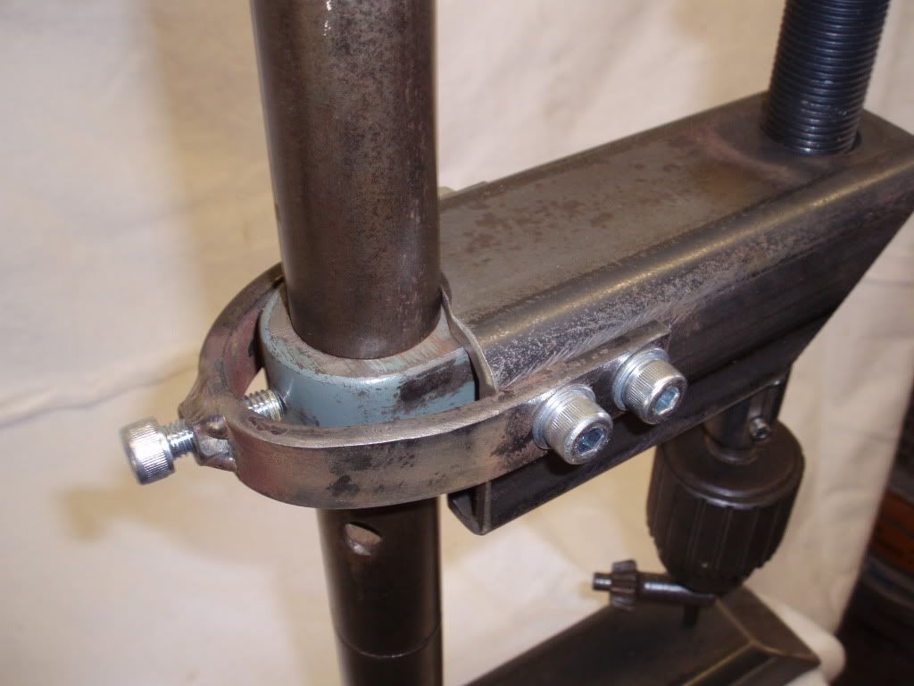

    The cast base and head were not large enough to fasten the working parts of the drill to so two sleeves were cut from 60x60mm steel box section and slipped over the castings and fastened in place. The bottom sleeve is fixed with 4 M8 caphead screws running into tapped holes in the cast iron base. For the top sleeve a 1”+ clearance hole was bored at one end and concentric with this I welded on a 1”UNF nut.
    To lock the head to the pillar and minimize racking under pressure I filed semi-lunar notches to the profile of the pillar on the steel sleeve. Then a steel stirrup was bolted to the sleeve. An M8 capscrew running in a nut welded to the apex of the stirrup pulls the sleeve back hard against the pillar at a fixed 90degrees. This works well.
    The base plate is locked with an M12 capscrew running through a tapped boss in the casting and pushes a steel pad against the pillar.
    When I received Ross’s drawings and saw how simple the original crank handle and ratchet I fully intended to copy it. However in raking around my scrap pile I unearthed a Stanley woodworking brace with a non repairable chuck. The ratchet from the brace was slipped over a spigot turned on the top end of the new drill spindle and cross-pinned in place. The rest of the ratchet housing then fits over this and is bolted in place, this time with an M6 capscrew. A bit of butchery of the brace crank, M12 threads cut on the ends of the two resulting pieces and the whole lot joined together with an extension nut and locked with two full nuts.
    The Jacobs chuck is again from the scrap pile and is locked to the main spindle with a couple of grub screws bearing on the chucks plain spindle.
    The whole job is yet to be painted but I have tried it out and have to say it works really well. I can fully understand the rave reviews that Coles drills receive on this site.
