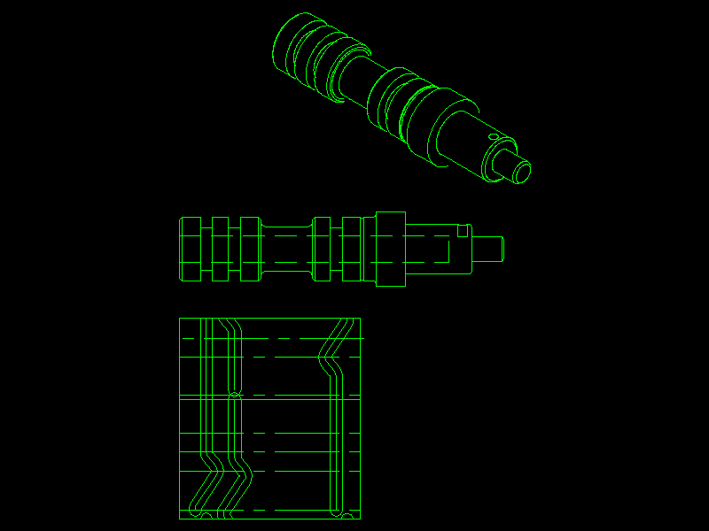

    Dolphin which is a reasonable cheap program will do 4th axis work quite easily.
    You draw out in the flat with the Y axis equal to Pi x D
    You then select the profiles you want to cut and bracket them in the operations list with > Start 4th axis and < End 4th axis
    Anything inside these brackets then gets automatically transferred to X and A moves.
    You also designate the OD of the work so it can accurately work out the correct feed rate from linear to rotary.
    Finished job.
