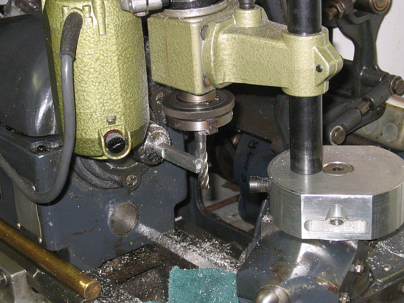

    Awesome! Because of the smaller size it looks as those the unimat is easier to mount in different positions than the 6" atlas would be. I'll have o start looking for a complete unimat headstock now I guess.
    Thanks for the pics Paul!!
  2. #12
    May 2002
    Beaumont, TX
    5,929
    It's not only the smaller size, but also the fact that it is designed to rotate 360 degrees on it's mounting pin. The drilling or milling jobs I have shown could have easily been at an angle to the lathe axis.

    When I originally thought about getting a lathe head I looked into the unimat and even watched a few auctions on ebay. But than I found some measurements of the unimat and thought it would be to small to handle endmills and small cutters and whatnot. So than I started watching for a 6" atlas. But after the pics you posted and the info I am glad I didn't get the atlas yet.
    Now the unimat prices are going to go up because of you.

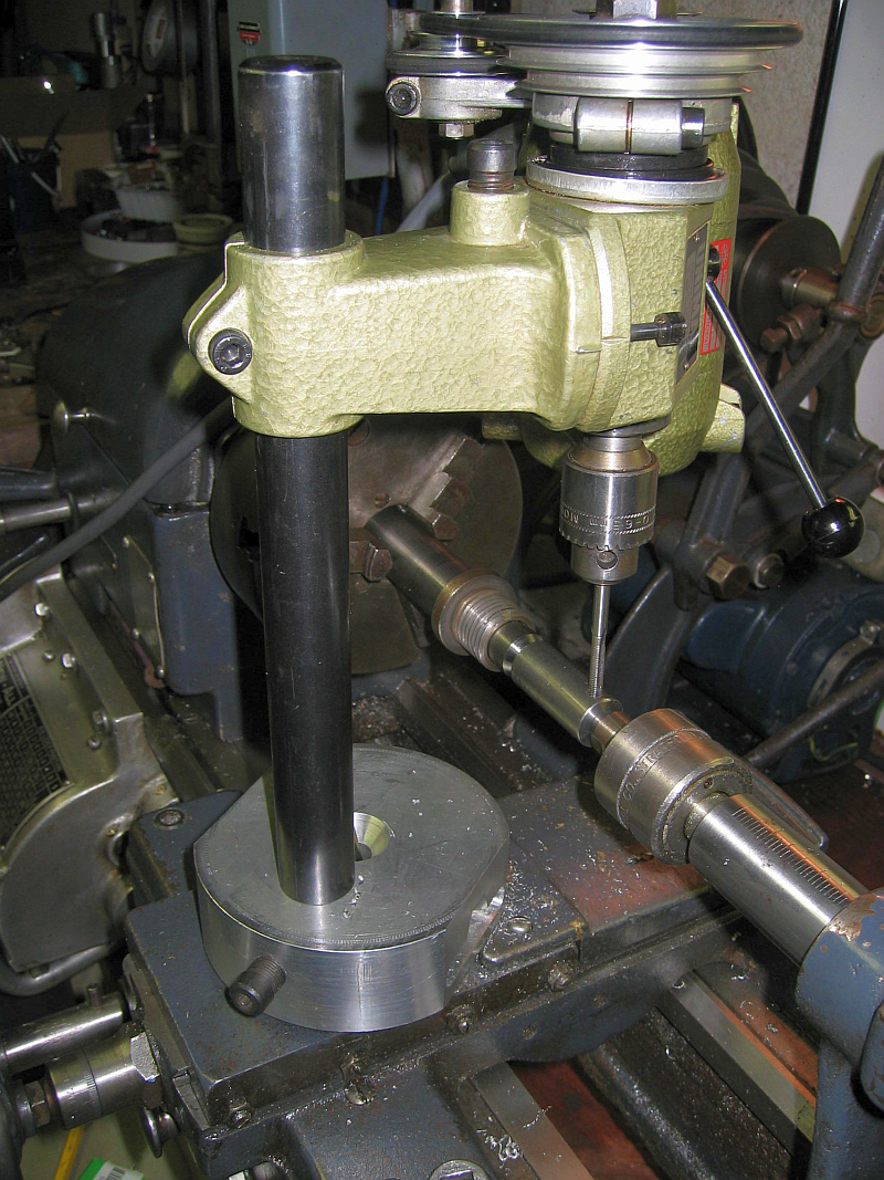

    unfortunately going to school takes away details ... not unlike sandblasting your brain . so I apologize for not remembering the name of who on this forum I blatantly stole this idea from.
    base mounted in the toolpost
    base mounted in place of the compound
    at some point I expect I will make another mount point off the edge of the disk but I haven't needed it yet.
    edit. it is on a 10x24 Logan in this case

    Thats the beauty of the Unimat..
    For 645 UK Pounds (~ $1031.00) for that quick step mill, or the time needed to make it...
    I could buy a old Bridgeport Mill.... (don't need 2 tho...)
    Or buy 3 or 4 Unimats...
    No modifications needed at all to it...
    It is already designed for light milling and flexibility.
    Especially flexibility
    With care, it will do decent light work...
    A couple adapters for Compound slot and done ...
    I have most of the attachments, and will sharpen some end mills on it, when I get a couple more dull ones..
