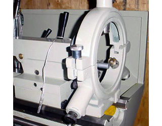

    So based on the advice here I'm trying to order a factory steady rest for my Victor 1640B from Machinery Solutions in California. I received a fax with a quote which had two disturbing items. One, they want $700 for the steady rest. That's more sticker shock than a real problem.
    The second problem is the specs for the rest says it will handle up to 7.5" and down to 3". I called to make sure that 3" was as small as this thing went and they confirmed it was. I realize with a 16" swing lathe I may be a little oversized but a minimum of 3" is just way too big to be any value to me. Am I missing something on what this steady rest really does? Don't tell me I need a spider for a steady rest too! I'm about ready to just build the doggone thing. Any advice out there on what I should do for a steady rest? I'm mainly worried about turning gun barrels right now, but of course a steady rest is useful for many things.

    3" doesn't sound right to me. 0.3" is more like it. I'd call them again and speak to a tech person.
    Did you see picture of the steady?

    I did not see a picture of the rest. I just received a fax quote from them. I talked to the guy who is in charge of steady rests (that's a job??) and specifically asked him about the 3". I told him I needed to be able to handle 1" at least. He said this might do 2.5 inches, but it does sound like English may be a second language. 0.3 sounds a lot more like it to me as well. Why the heck would you only handle down to 3 inches? However, I'm holding the fax in my grubby little hands and it says:
    1640B Steady Rest* with roller tips......... $700 each (In stock)
    *Capacity 3" to 7-1/2"

    Hate to state the obvious, but the manufacturer's web site ....
    http://www.victormachines.com/site/CatalogProducts/106
    Shows many pictures, such as :-

    No please, the obvious is usually what I miss. I did see those pictures on their website. Unfortunately I'm ignorant of how these steady rests adjust. I cannot tell how close in they adjust from those pictures since the rest seems to be in it's most open setting. You guys that are more experienced with these things, do you think that rest adjusts to a smaller setting than 3"?
    As for having two different rests for different work, I'm with you. The problem is, according to the vendor they only make one model of steady rest for my lathe. The more I think about it the more I think it HAS to adjust to less than 3", but I sure hate to order a $700 rest and be wrong.
