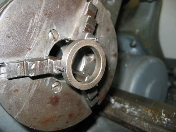

    This is the way to do it:

    Here is how I have done it. I use a dremel or toolpost grinder to do the actual grinding. Depends what is available at the time. You need to "spark out" really well. Idea is from Rich Carlstedt.
    Drill some holes in the jaws with a carbide drill, and set the ring.... puts a load on the chuck virtually identical to actual clamping load.

    That's thinkin, good Idea JT and Rich, and nice jig Macona...
