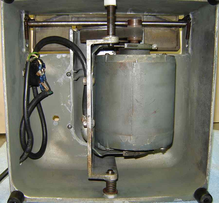

    You prompted me to look at these. From what I can tell, there were a few makers until recently: Kool Kut, Cold Grind, KK Calamar (same as Kold Kut??) and Accufinish. All I can find now are Accufinish and two in-stock KK Calamar grinders at MSC. I think all but the Accufinish are now defunct. I see the pictures of the others and think Heavy Duty, Cast-Iron Monstrosity ...as mentioned. I also found this webpage: http://www.gadgetbuilder.com/GrindRLap.html Look here, though: http://www.gadgetbuilder.com/GrindRLapBottom.jpg Sure it is cast (Aluminum), but the impression from the top gives a misleading impression
    From what I can tell, these are all essentially the same except for one feature. On all but the Accufinish, the wheel moves side to side. On the Accufinish the table moves side to side. To continue with the Accufinishes, it looks like the major difference other than size between the Model 1 and the Model 2 is how the table moves. The series 1 uses a rod & bore to slide the table. The series 2 uses a ball-bearing slide. For those that have used both, is the movement of the series 2 table noticeably smoother? In other words, is it really an 'upgrade' or is the series 2 just intended to be a more permanent, freestanding machine---what with the optional stand and all.
