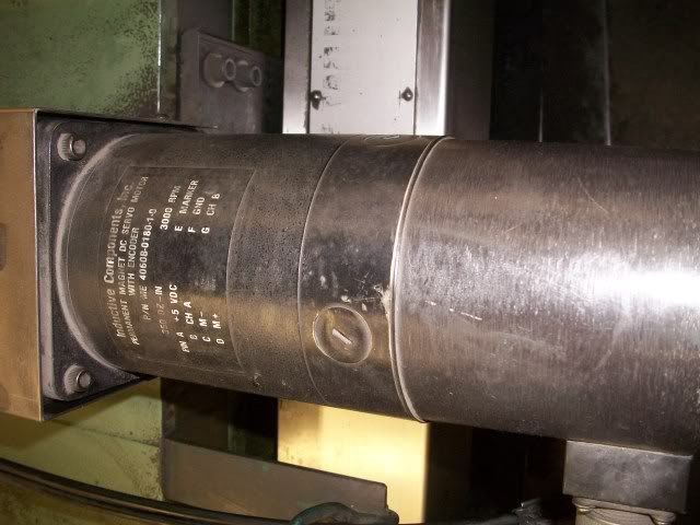

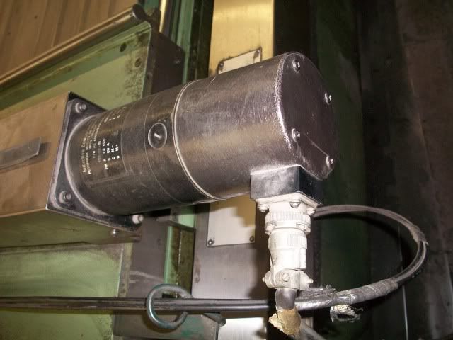

    Hello gents,
    New to this world, so please bear with me. A customer of mine, has a CNC controled punch press with servo motors. Several months ago they called me complaining of "forcing" sounds, and homing issues on start-up. Once homed the machine would run fine for the rest of the day. A couple of days later the mother board blew up. I sent the whole unit (controler only not drive cards) out and got it repaired.
    The shop said everything was fine. Unfortunately the "Forcing" sound did not disapear. A month later the mother board blew up again. A new one was sent and installed. This was 3 weeks ago. So far so good.
    Ok my questions is , what would cause an issue like this? And only during the start-up? They will be shutting down for the holidays so it might be a good time to do some work. Any ideas, suggestions are welcome
    Rob. Here are some pictures

    It would help if you mentioned make and model of machine,control and axis drive.
  3. #3
    It is a creonics controller built in 1986-7.
    The motors are Balador model M4090b 90v DC with up to 25 amp 110v ac/dc input.
    No load speed is 2022 rpm.
    The motors can put out 2.3hp.
    Rob

    Check the motors for carbon build up.
    I`m finding it difficult to get the connection between the motherboard and the servo motors/drives unless it is voltage spikes caused by leakage through carbon build up and a poor earth.
    Best way to tune any servo is to run it on it`s own independently from the control using a battery box.
