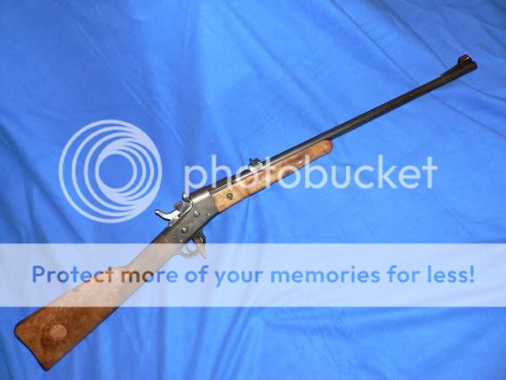

    Early last month, Simpson's had quite a few Swedish 1867 Rolling Blocks for sale. Some had been de-milled by having the chamber welded and were offered at $195.00.
    I took a chance and ordered one, figuring it was a good price for a roller action alone. Being an antique, it shipped directly without going through an FFL. When it arrived, I was pleasantly surprised by the condition it was in. Metal and wood wood in good shape, the gun was complete and functional with all numbers matching.
    The chamber had about a 1/2" bolt TIG welded inside with no damage to the breech or extractor. The firing pin hole had also been TIGged closed. I pulled the barrel and drilled and bored out the plug. While the chamber could have been salvaged, the 8X58RD chambering was not to my liking. I shortened the barrel 6" to 24", installed a liner from TJ's and chambered to 357 magnum.
    I had to bush the breechblock as the TIG welding had created an HAZ that refused to yield to a HSS drill. The rest of the project consisted of reinstalling the front sight, shortening the forearm, stripping the wood and giving it an oil finish. I elected not to refinish the metal as is is in good shape and has the various proof, inspection and rebuild markings that trace the history of the gun from when it was manufactured in 1872.
    I got a brief chance to take it to the range and give it a try last week and am pleased with its performance. It shoots very close to point of aim at 25 yards with the lower leaf of the two leaf rear sight and seems to shoot fairly flat out to 50 yards. It was a bit too cold to do any extensive shooting, but it looks like it is a keeper.

    Thanks Frank, it did make up into a trim gun. If you are considering 44 Special, take a look at 44 Magnum or even 444 Marlin, they all share the same basic case. I went with 357 Magnum as I have a revolver in that caliber and it will share components and reloading tooling.
    As I understand, the chambers were welded due to a Swedish law. Functioning guns must be kept in locked storage. If a gun is to be used in open display, it must be deactivated. Apparently a large number of these received this treatment.
    These guns have quite a history behind Them. this one was originally manufactured as a 12mm military weapon. It was manufactured under Remington license by Carl Gustave. In 1893, it was converted to 8X58R. At this time, it was rebarreled, the hammer and breechblock were replaced, the extractor converted from sliding to rotary and the receiver re-heat treated. This conversion was also done by Carl Gustave.
    At some point in the early 1900's it was converted for civilian use. The full length military forestock was shortened and the handguard removed. The brass medalion in the buttstock removed and the "checkering" applied. The barrel was shortened to 30" and ramp front and two leaf folding rear sight installed.
