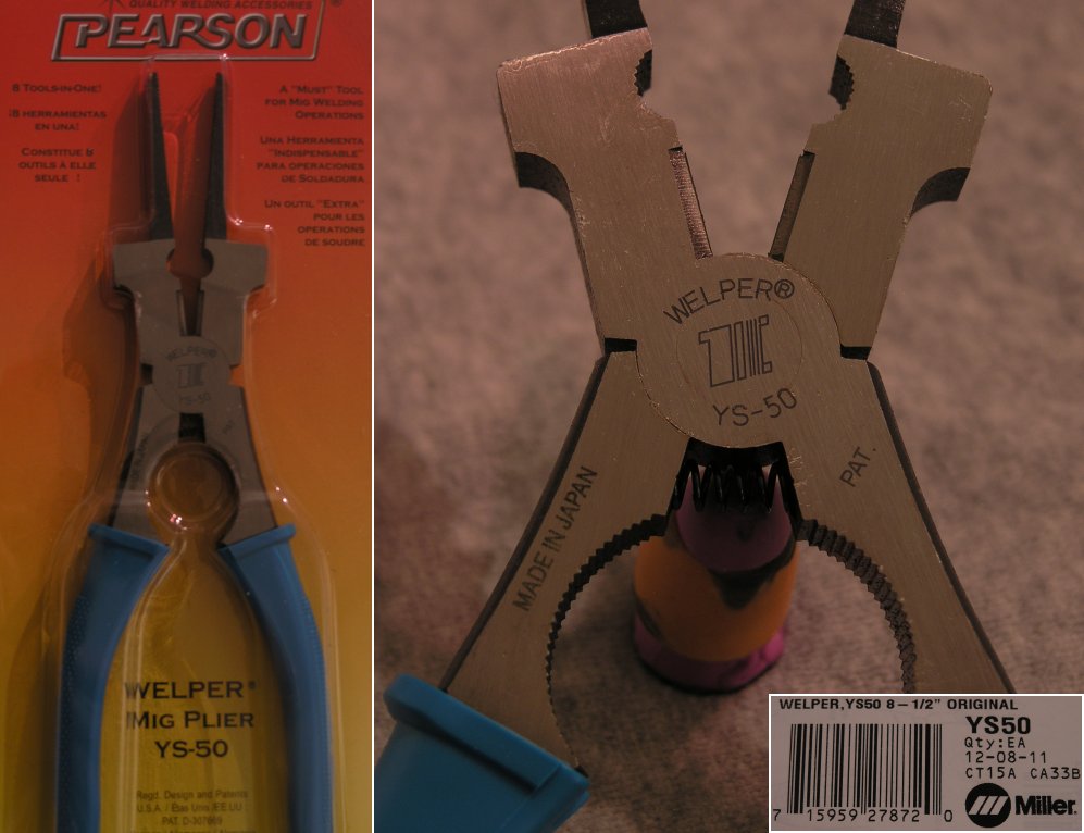

    Here is the authentic WelperŪ plier
    These are packaged by Pearson and the Miller lable shown at the bottom
    right side of the image was stuck onto the back of the Pearson package
    I received.
    I suspect that the pliers packaged by Anchor are also genuine WelperŪ,
    but do not know with certainty.
    The forging and the finish of these WelperŪ pliers are leagues beyond
    that of the pair packaged under the Shark Welding brand that I received
    first. A better grade of plastic is used for the WelperŪ grips and, unlike
    the Shark unit, there is no molding flash. Lastly, the WelperŪ cost 70%
    of the 'Trade Price' I was charged for the Shark unit.
    My vote is that if you are shopping for a quality pair of mig pliers, the
    WelperŪ is the most satisfying choice. Just be careful that you don't
    get tricked into ordering a counterfeit substituted by an unscrupulous
    vendor.
