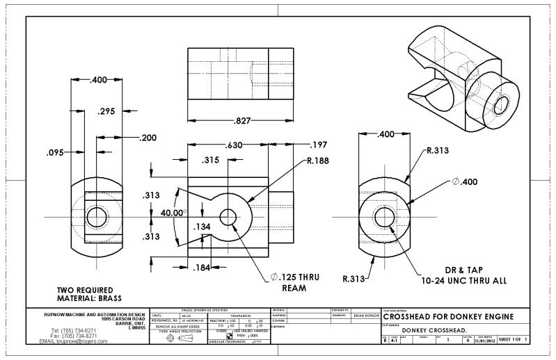

    And more---Damn, there's a lot of parts to a Donkey!!!
  2. #22
    Mar 2008
    Barrie, Ontario, Canada
    3,342
    And my last bit of Donkey Doo for today---

    My nice long design contract across town is limping to an end. The design work is all finished and I'm just waiting for all the various machined parts and weldments to be completed and brought "in house" so I can supervise/orchestrate the final assembly of the machine. In the meantime, I get to spend quite a bit of time at home, and consequently get to spend day time hours designing my toys. In a way I am covering new ground here, as I have never completely designed a steam chest and slide valve on my own. On all of my previous steam engines I have copied other peoples designs. This time, using the original Popcorn design by Stew Hart as a starting point, I am changing port sizes and eccentric travels, and a host of other related items. I haven't posted drawings of any of these changed items, because I first have to convince myself that the changes I have made will work properly. I'm off now to the bank to pick up a wheelbarrow full of money to buy brass at my local metal suppliers.

    I have been studying Captain Jerry's clutch mechanism which he came up with for his Donkey engine build. It is indeed a clever mechanism, and there are some vitally important parts that simply don't show up or get mentioned in his posts. I have wore my "engineer detective" hat all morning, and I'm pretty sure I have sussed out how Jerry did it. I am going to post a drawing and a few solid models to show how I believe this clutch works.

    These two models show the components inside the clutch. Of course that purple shaft with the round knob on it which I called an "activation pin" is in there only for "show and tell". In reality it will be a short pin operated by a hand lever to engage and disengage the clutch. There will also be a spring under that sliding hub which under normal circumstances will hold the sliding hub away from the winch so that the clutch shoes don't constantly "drag" on the inside of the winch drum. I will post more about that lever as my design progresses.
