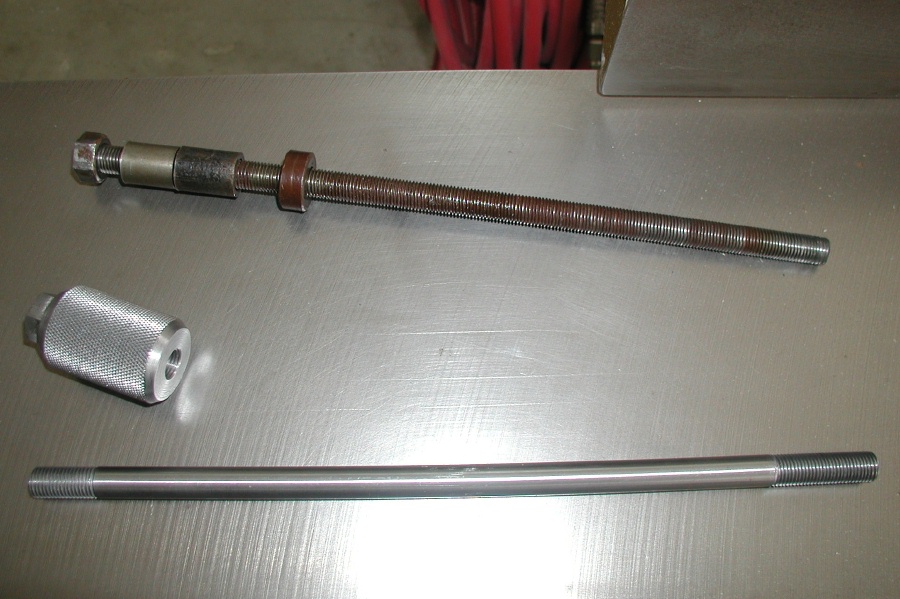

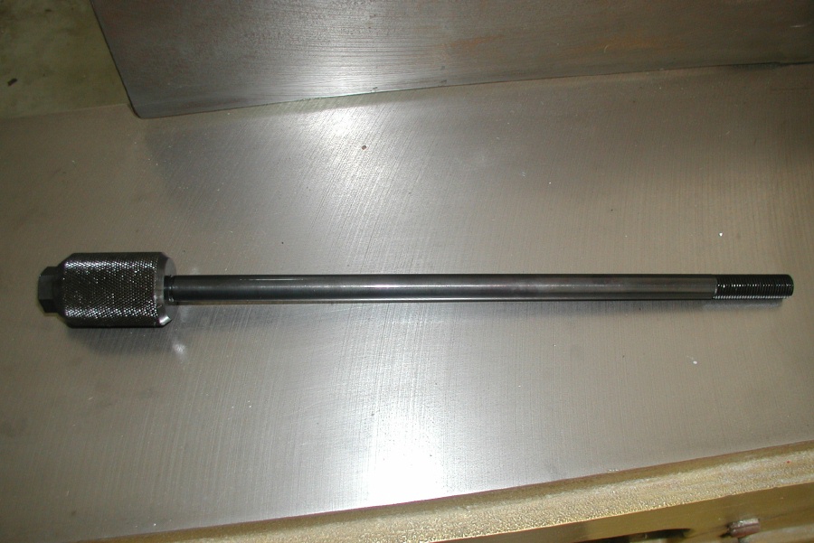

    Quote Originally Posted by willmac
    The old is just a dog poop 7/16 threaded rod and loose nut.
    The new is below, a knurled top piece with an 11/16 hex integrated into the design. I used O1 tool steel (unhardened) for the rod, I think the better steel is less likely to stretch under tension or cross thread in a collet.
    Here it is assembled with Loctite and fresh out of the black oxide solution.
    And now installed on the mill, ready for action.

    Goose -
    That looks very good. You will appreciate it every time you swap tools, which if you are like me is frequently.
