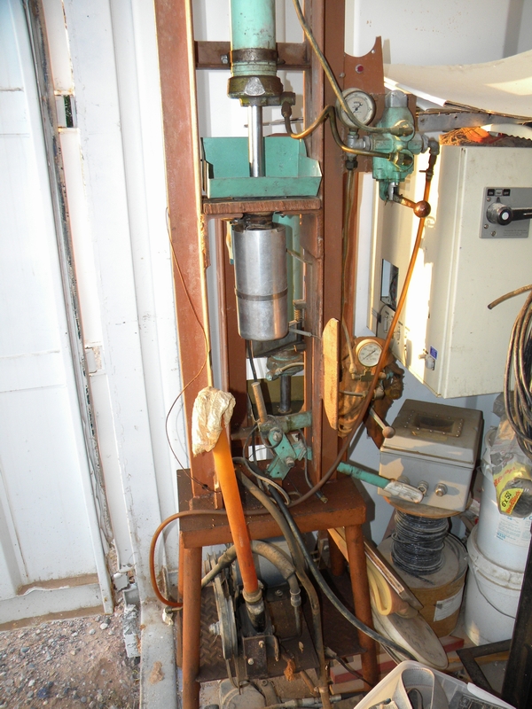

    Here is a possible solution if you have the time.
    Made from a military surplus aircraft landing gear, a pipe wrapped with nichrome wire with a sensor and a power steering pump for pressure.
    I can do about 6 cc of PVC or ABS with it.
    You can throw one together for next to nothing but you will still need the mold.
