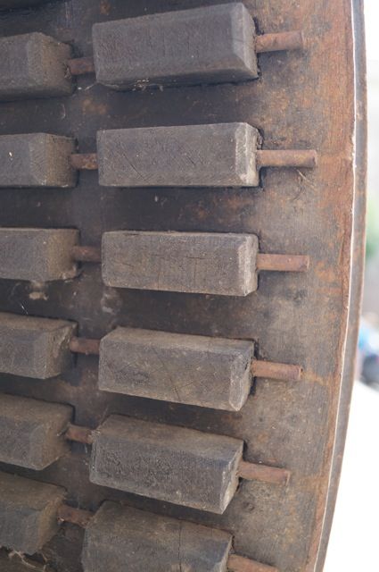

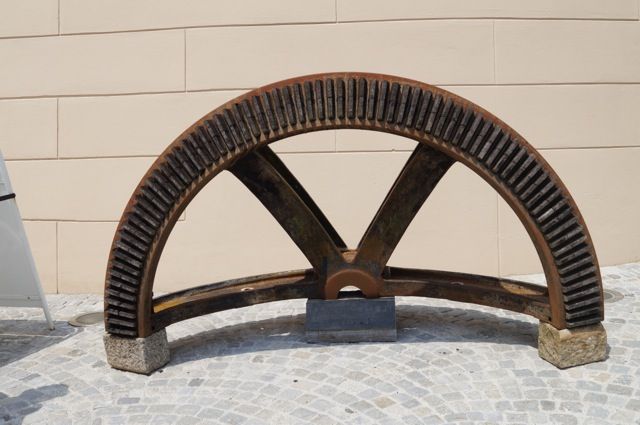

    I had occasion to recently visit the Benedictine Abbey, Stift Melk, located outside Melk, Austria.
    http://en.wikipedia.org/wiki/Melk_Abbey
    Outside the abbey was a partial remnant of of an old gear with a frame of iron and wooden teeth. The wooden teeth were pinned to the metal frame and spaced by a wood layer over the frame. Interestingly enough, sufficient wear had occurred to give the wooden teeth an involute curve although the attached pictures don't really adequately show the wear pattern.Wooden components appeared to be Oaken.

    Fascinating! When you need to do a thing, you find a way. And easily maintainable, just replace the individual teeth. I wonder if anybody does that today. I mean, turbine blades are replaceable so why not gear teeth. Anybody know of any modern examples of replaceable teeth?

    I wonder what it was a part of.

    I wondered if the gear had broken, or was cut for display, but it looks like the frame was made from 2 identical halves and bolted together.

    It looks like the end grain is across the top of the tooth. Can that be right? I realize there is no load there, but I would think it would still split easily.

    Those are wooden cogs, hence cog wheel. They are quarter sawn for dimensional stability.
