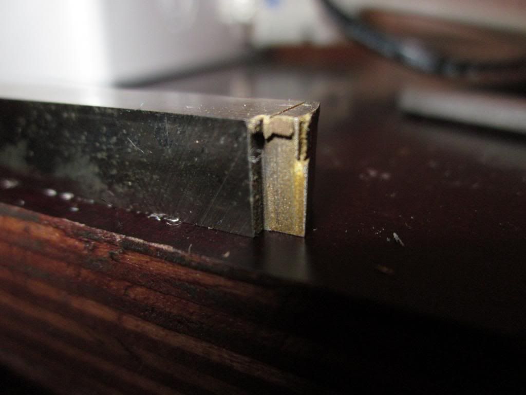

    Hello again
    My DIY wire EDM project has entered cutting test stage in the recent week or so and the most recent video of a test cut is here (nothing special happening between 1:30-6:30):
    The cutting went nicely, but what is bothering me is the brass welding in to the already cut gap behind the wire. This makes a kind of tab that holds the cutoff portion in place. It can be loosened with fingers, but it shouldn't do this.
    Here you can see a picture of the problem, the nudge of brass at the upper edge:
    I'm interested in knowing what causes this kind of thing, as I haven't had much time or wire to do thorough testing of everything yet. Sometimes this kind of welding happens with 1 mm thick steel, sometimes it cuts without this issue and the last test with 40 mm thick steel non-submerged showed no welding.
    The best cutting speed I have measured to date was 8 mm˛/min. Not bad for first tests, as the worlds first commercial wire EDM cut with a rate of 21 mm˛/min.
    There are a lot of variables in this, I know, but if someone has come across this kind of problem with a commercial machine then please do tell what was wrong. Or just give your best guess

    Do you have the correct polarity? If the brass is transferring to the steel maybe try reversing the polarity so the steel tries to plate to the brass wire as is flows away. I'm just spit-balling though. As someone who is thinking of making a homemade EDM or possible electro-chemical machining center I'm glad to see a well made successful unit like yours.

    Try a different material, maybee brass is dooing some wierd zinc sublimation thing?, just guessing though as the only edm i have done was cutting tensile test peices years ago, all steel btw.
    Laser cutters get trouble with brass too, or so i have been told, requires extraction of fume from the cut?

    macona: Thanks, I appreciate if they can get some idea. I'll also ask from the wire EDM guys at my old work place once I have the time to go there, but what i used the Fanuc machines at that time didn't produce such results in workpieces, so I might not get lucky.
    andywander: The brass is coming from the wire, the workpiece material is HSS. I have had this same thing happen on steel also, but this was the only piccture I got of it at the moment. And about my signature line, it is a very bad machine translation of a 'wisdom' from my workplace
    robosilo: The polarity at the moment is positive at workpiece and negative at wire. If they are reversed, no cutting happens. There is no plating action going on I think, otherwise I would see the plating all around the workpiece too.
    cidrontmg: Yes, good and cheap dielectric - plain water It is the wire EDM's dielectric, just tap water to the machine and ran through deionisation resin to remove conductance (5-20 uS is preferred value). And if you think a sinker EDM has lots of work, then this wire EDM has nothing but. The thing is that there is no manuals or walk throughs to follow, you just have to make and test it with the best of your abilities and knowledge. This is kind of reinventing the wheel independently, as I know from the commercial machines what they do and how they function, but to achieve that in a home shop machine is a lot of work. And because this is a kind of pioneer work, I try to document everything by photos, video, postings and publich everything under CC-BY-SA and GPL so that everyone else can also try the things I've done without paying anyone for it
    boslab: I've tried HSS, steel and stainless steel. The stainless cuts nicely as does the steel and so does the HSS, but for some reason the brass from the wire welds itself like in the picture to the workpiece sometimes, especially if I try to cut 1 mm thick steel and sometimes with a 6 or 8 mm thick HSS, so it seems that the material I'm cutting doesn't play a role in it.
    Evan: Would love to see your brains working on a project like this and I hope all the best to you, hopefully you are around here for long
    What I'm thinking of the reasons for this brass from the wire welding itself to the workpiece is something to do with the flushing or the water quality or the power supply, as the material or the thickness doesn't seem to make a difference. But I've gotten this same result with flushing while non-submerged (dirty water or pure freshly deionised water), while flushing submerged (dirty and pure) and when cuting submerged with no flushing. Also tried different power settings on the machines RC generator, amps doesn't seem to affect it much, but haven't had components yet to test out adding capacitance (and now out of wire).

    Jaakko, you need good flushing. I'm only spit-balling here, but if I were to see that happen on my machine the first things I would check would be flushing quality, voltage gap, and wire speed. There is some degradation of the wire to be expected, but it is normally flushed from the cut and filtered out later. Check your top nozzle flushing pressure. In fact, increase it until you see the cut start degrading. This happens because the water jet pressure will make the wire bounce around, reducing cut quality. Also, you might want to increase the wire's speed so that there is not as much chance for the degradation. Lastly, the larger the voltage gap, the more power applied which will tie directly in to the previous two points. Try as smaller voltage gap. Disclaimer - I am not a WEDM technician or application engineer. Just a lame sod with a cavity of detritus sitting on my neck, who happens to own and run one most days of the week. Good luck, and great job thus far.
