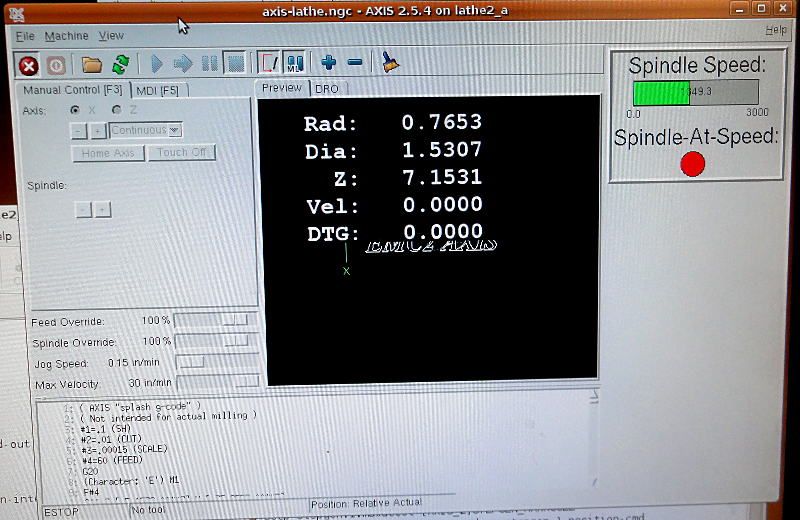

                    As for rpm feedback, the quadrature pulses are not used for rpm readout, only fine feedback info for threading etc. The index is what is used for a rpm display. To get a rpm display it has to be setup in the hal file and a onscreen readout of some sort setup. Did you use stepconf to do your original setup/hal file? If you did there are a couple of checkboxes that will create either a pyvcp or other rpm display box onscreen. A realtime rpm display with index feedback is not needed for operation. On a lathe, the spindle encoder IS needed for threading operations though.
                    Here is some info http://linuxcnc.org/docs/html/hal/pyvcp.html

                      Let's see if I can find a pic of the RPM display. Upper right corner.
                      My tach is different than yours -- just a single sensor -- so your setup will be different than mine, and you may need to ask for help on the LinuxCNC forum. I ended up having to add a software debounce to my tach signal to get it to work reliably.

                              It sure isn't feeling quick right now! I got the spindle speed panel to display and added the hal commands to make the display follow the spindle speed so I am confident all the hardware is correctly connected. I have been assuming that the correct way to move the Z axis at a feed rate tied to the spindle speed is to use G95 so I have been trying variants of:
                              G95 X1 Z+1 F.002 followed by
                              G95 X1 Z-1 F.002 to move it back to where I started.
                              This does move the carriage the direction and distance I would expect but the F parameter and the spindle speed do not have any effect on the speed of the carriage. So I guess my questions for today are:
                              Should I be trying to use G95 or is there a better way to do this?
                              Am I specifying the F parameter correctly? I was hoping my example meant 0.002" per revolution.
                              Do I have to add something to the HAL file to somehow map my spindle speed to something in addition to the spindle speed readout?
