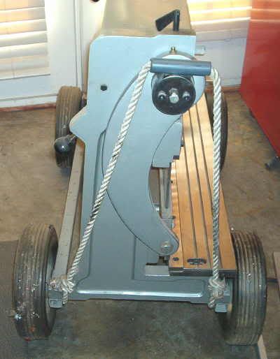

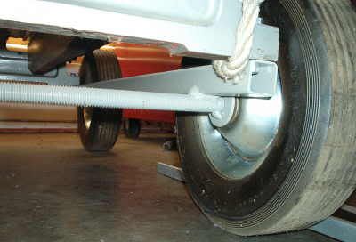

                            I don’t use this machine frequently enough to dedicate valuable bench space for it. This thing is heavy (over 300 lbs for the 30â€‌ model), so I built a minimalist cart out of some cheap H.F. solid tires, a couple of 30" long pieces of 1â€‌x1â€‌ square tubing, and some thread all. I tied some rope around the frame to use as a handle. I later added a short piece of PVC over the rope so it wouldn’t pinch my hand when pulling it around. The wheels and handle make it quite easy to move around.

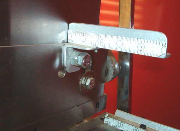

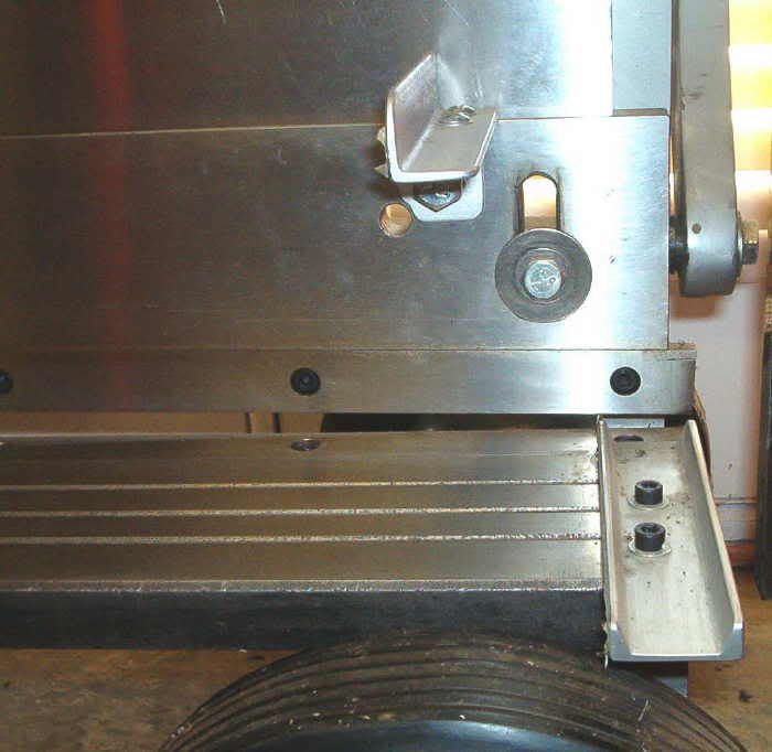

                            I wanted an easy way to align a piece of metal in the press brake and there was an unused tapped hole on the die, so I made this alignment gauge out of 1â€‌x1â€‌ angle. It is self aligning because the fence piece hangs over the die about 1/4". I should add a piece of flat stock to the bottom of the angle to add support to the piece being bent. The 1â€‌ of support that I currently have helps quite a bit, but it would be better if it were full length. Now I can get away with a little mark for length instead of a full length mark at the bend line. This has turned out to be a very convenient addition.
                            I also replaced the tiny and non-square fence that was included, with a longer piece of 1â€‌ channel. I put graduations on both fences, but probably shouldn’t have bothered.
