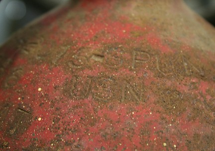

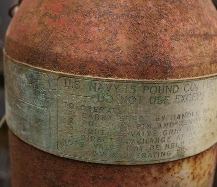

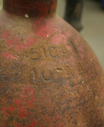

    replied
    That reminds me... I have a WW2-era USNavy 15lb CO2 extinguisher I've been meaning to refurbish and set up as both a cool display and a useful safety device.
    Assuming, of course, that it will pass hydro.
    The one and only time it was hydrotested was October of 1944:
    Unless the upper number is "41", but I think that's a serial type number rather than a previous hydro.
    The valve looks in good shape, though the hose is rotted. The wood handle is cracked but the "horn" is in great shape. The external rust pitting is mild and shouldn't affect the strength. My only concern is internal damage, but if course they'll find that when it gets tested.
    I was going to try to carefully remove the smut from the band- which I think is brass or bronze, like a machine dataplate- as well as the tarnish from the valve (which I think is also bronze) paint the tank, replace the hose and handle, and build a wall hook for it. Or, maybe find an authentic one somewhere.
    Doc.
