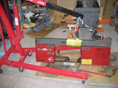

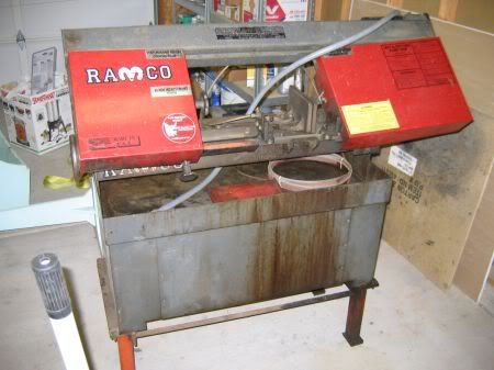

    I've finally completed the teardown and cleanup of my Ramco bandsaw, given to me by my father-in-law (in Oregon) and delivered by a good friend who happened to be driving from Oregon to Arizona with his truck and was gracious enough to deliver the saw to me (going about 200 miles out of his way to pick up the saw from my father in law)
    Here's the saw in as-delivered condition. Not bad, but could use a little cleanup

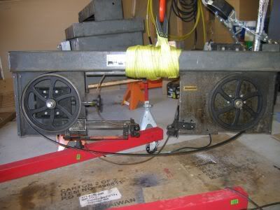

    The next Two I'm dissassembling it into pieces
    Here I've stripped off all the paint and applied some of that Jasco metal prep before painting (Note to self: apply Jasco SPARINGLY in the future -- it dries sticky)
    And jump ahead a little bit to the completed pics.
    This was my first time using a real spray gun to apply the paint. I don't think the topcoat adhered as well as it should have to the primer coat. I used Rustoleum's rusty metal primer followed up with Rustoleum's 3400 system (Low VOC Industrial Enamel - Navy Gray)
    Chad

                    Excellent job! Almost looks too nice to use. What is the capacity of the saw? It looks like it will take a good size chunk of material.
                    Frank

                        This saw has a lot "adjustment" built in to the blade guides, which becomes somewhat of a PITA during assembly. I found that removing all blade guides and getting the blade to track well in that condition worked best. The I installed the guide bearings around the blade; that method worked quite well.

                          To be honest, I'm really not sure what the capacity is. Some quick measurements suggest that I could cut a 7" x 10" piece, possibly slightly larger, I'm not really sure. I haven't looked at blades yet, but my manual says it takes 1" wide x 115-1/2" long blades.
                          <font face="Verdana, Arial" size="2"> Posted by Flatline's Up!:
                          I think you should have used a few more wraps on that webbing lift strap, just to be on the safe side...</font>
                          Yeah LOL :-) Not having moved any heavy equipment yet, it's the only lifting strap I had, and it was WAY too long for the job, so I just wrapped it a few dozen times.
