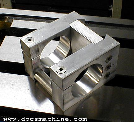

    I had to do up thirty pieces with a coarse, short internal thread with a shoulder. Standard threading with a short bar was becoming time-consuming (and wasteful) since turning too slow (so I didn't over-run) left a poor, ratty finish, and turning faster gave me little or no reaction time- I'd either over-run, crashing the part, or I'd under-run, so the threads wouldn't be deep enough.
    So, in one of those cases where making a time-saving tool cost more time than it saved, I made up a "powered cutterhead" so I could cut the threads to nearly full depth in a single pass, slowly and carefully.
    First, I made a mount for my wedge-type toolpost:
    That holds an air die-grinder like so:
    I removed the hand lever, and the "button" is just tucked inside one of the clamping rings. The input air now has a flow control (quick and dirty speed regulation) and a 1/4-turn shutoff.

          Actually, no, the cutting takes place at 9 o'clock (looking at the chuck) just like usual.
          I didn't think about having to angle the cutter to match the thread pitch until I'd already built the mount. I toyed with remilling the dovetail to match the necessary angle, but again, this was a customer run and time was getting short.
          I "built in" the center height to the mounting block, there is no adjustment at the moment. When cutting, I simply left the depth-of-cut a tad shallow, and let the cleanup tap make sure the thread form was correct.
          I had thought about tweaking the toolpost itself a bit, and either cutting at the top or bottom, but due to the slack in the geartrain, that recut a partial thread on the backout (I experimented with a piece of scrap) and ruined it.
          It wasn't perfect, but it worked, and the threads are correct as near as I can tell. I may whip up another one eventually, with a bit of angle adjustment for the thread pitch, or even put some sort of adjustment into this one. In any case, the job got done and I can ship in the morning.

                    No, I don't have a boring head for either the mill nor one large enough for the lathe. I did the large holes with the plates in the 4-jaw, stacked together.
