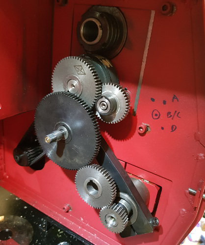

    Come up with a new crazy idea. Should just about be able to shove an idler gear on the same banjo and run the A gear off the other spindle to compensate for the direction change. Seems to fit for 60-40/90-50-30 which should give me 9mm pitch. The extra spindle, t-nut, sleeve and key are all available as spares too so I might give that a try.
    Leave a comment:
  • Cenedd
    replied
    Thanks Baz. I do have two 120's, yes. They won't fit in the A position though as anything larger than 60 will hit the spacer on the drive gear. I've already slimmed the spacer down but unless I shorten the drive gear shaft down (and lose the option to reverse the leadscrew) I couldn't get anything larger on.
    This is the gears laid out as per the 60/30, 90/40 suggestion but with the 90 gear removed for visibility. The B/C shaft is set in the right location for meshing the 90 tooth C with the 40 tooth D. You can see that the B just won't mesh with the A because the end of the banjo hits the gear the sits behind A:
    With the A gear removed this is easier to see:
    Swinging the banjo all the way round doesn't help any of these combinations either:
    From the front, you can see what I was thinging about making a banjo that sits further back. It wouldn't get me much more clearance but make it just a bit shorter and it might clear the (fixed, static) shaft that carries the A gear. With a 100 tooth gear on the banjo meshed with a 100 tooth gear (largest combination on the chart) there's about 10 to 15 mm extra length of banjo than there needs to be.
    I could add an idler gear by mounting a plate to the two SHCS (rather than drilling randomly) but it dawned on me that there would need to be two idlers or it would reverse the direction.

    Do you really have two 120 as in your original list?
    120/40, 120/80
    120/60, 90/40
    100/50, 90/40
    100/80, 90/25
    100/25, 90/80
    60/30, 90/40
    50/25, 90/40
    Obviously above can be rearranged and 90/80 replaced by 45/40 and so on. I like the versions using both the 90 and 25 since you bought them specially.
    Earlier comments were about driving the leadscrew rather than the spindle. You have a big bolt/nut holding the gear on the leadscrew end. A ratchet spanner, or drill with adaptor to socket, etc will fit this. When running back to avoid the risk of undoing this bolt take the strain off things by a) putting a bungee on the saddle to the tailstock to pull it back so no effort from the leadscrew and b) simultaneously twist the chuck with your other hand so no effort from the gears there either.

    Well, I had a few moments to slap some change gears on spindles. Used the Sharpie trick again and got full coverage - or the whole bar turned green. Not quite what I was intending! Quite the opposite in fact....which led me to realise that I'd got the calculations the wrong way round and had produced a 0.444 mm pitch thread. Sorted my calculations out and have found a number of combinations that would work....if they fit on the banjo.
    My A spindle will take a 60 tooth max (had to turn the spacer down slightly to get that much) but most of the combinations fall apart when to get the B gear to mesh with the A, the end of the banjo then hits the gear that sits behind the A gear. Doesn't help if I spin the banjo round to mesh from the other side either. Tried these:
    45-30/120-40
    60-40/90-30
    45-40/120-30
    This one may be more promising - will try to simulate it but I've not got a second 40 tooth.
    60-40/120-40
    If anyone has any thoughts on combinations I've not come up with, I'm game for trying them but otherwise I think the potential ways of getting round this may be unreasonable for just being curious/stubborn/bloody-minded. That said, 9mm pitch would be ideal for winding a compression spring I 'need' to make. I'm curious though - partly as a thought experiment, partly to learn and partly should the need arise - what the options for getting round this would be. I can see a few options:
    1. Cut down the end of the banjo. Not ideal as I'd probably be removing the ability to use more useful combinations and end up having to buy/make another banjo.
    2. Add an idler gear into the train between A and B. Not sure if I can just hijack one of the SHCS that is in roughly the same place or if it needs to be somewhat more secure for a spindle - maybe a flange?
    3. Same as 2 but slidable so different size idler gears can be used.
    4. Make a 2nd banjo that pivots further down the D shaft and hence will clear the spindle gear (one on same shaft as A) and would allow either the gears to be meshed or an idler positioned if/as/when in addition to gears on the 1st banjo.
    5. Some overly complicated replacement banjo that would mount more gears and probably need to be angled to fit them - I may just have "invented" a quadrant.
    As I say, I'm not planning to do this currently but it's going round and round my head so would appreciate comments on how it would be done so I can mentally put it to bed for now
