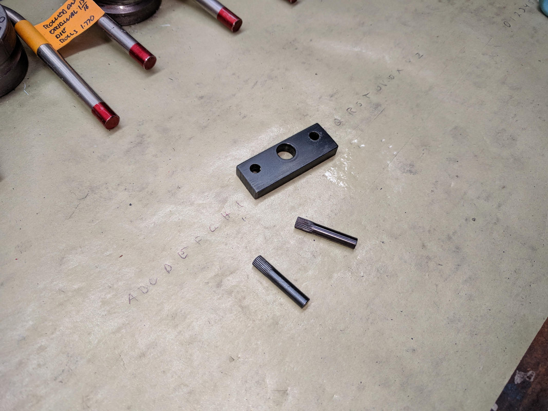

    I'm trying to find a source for this knurled end dowel pin or what ever you want to call it. These are used for the KO Lee base fixture lock clamp.
    I gave KO a call this morning with the PN#. The guy looks it up and says 83. OK, I'll take 10 of them. He says are you sure, I said well at 83 cents I'll keep a few on hand for future use.
    He says no, they are $83 dollars each. I said well why didn't you say you didn't want to sell me any.
    These pins measure .186 in dia. the knurl is about .190 + - and is about 1/4" long. The OAL of the pin is 1"
    I tried making one, but the collett just wouldn't grip the 3/16" dia. rod with enough holding force for me to straight knurl the end, it kept slipping.
    So does anyone know of a source for these??

      It might, but the knurling is a little too long and would probably jam in the fixture hole.
      If I could keep the rod from slipping I could make them.

                I do have an aloris clamp type knurling tool. The problem I ran into is the 5c collet doesn't grip the 3/16 diameter rod with enough gripping force to keep it from slipping, otherwise I would have been ok.
                I'm I'm not worried about trying to line the splines up, the clamp bar is soft. I made a couple of them.

                      No, nothing wrong with my collet. A 5C at 3/16" has about 5/8" length of gripping surface, mabe a little less and just not enough surface area to sufficiently hold the rod from slipping when knurling.
                      What I will do today is make a 1 1/2" long split collar. That will give me a lot more gripping length. My chuck won't close small enough to hold 3/16" dia. stock. 5/16" is as small as it will go.
                      I've made a lot of split collets to hold small dia. parts.
                      JL..................
                        I would go with the McMaster pins and turn or grind the excess knurl down to pin diameter.
