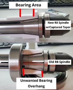

                Hello,
                I get your point about the convenience of rapid tool changing.
                Apparently GlockCNC makes R8 headstocks that can be used with TTS on a Taig mill.
                So after researching, I've drawn up this package below. Tell me if you agree :
                1) Purchase a CNC Taig Mill with ball screws but MINUS their headstock and motor.
                2) Purchase an R8 headstock (and corresponding draw bar) from GLockCNC as mentioned here.
                I assume this would enable me to rapidly change R8 tools - with a cordless impact driver.
                Maybe its not as fast as the air pressure based system. But its good enough for me :
                New Low Profile R8 Mill Headstock For Taig & Sherline! The Low Profile R8 Is Best…Hands Down One of the common drawbacks to the R8 is how far the spindle sticks below the bottom bearing. This creates increased pressure on the bearings…and nobody wants that. The obvious issue is bearing wear. The other major problems ... Read more
                3) Purchase a more powerful motor (about 3/4 hp ?) as mentioned by John's video below.
                Either that or the 750 Watt (1 hp) motor offered on GLockCNC's website :
                I've had a serious case of Tormach envy for a while now, and had strongly been considering upgrading to a 770M. But I'd heard about problems with backlash on...
                Optional upgrade :
                There is a more sturdy frame upgrade for the Taig as described in John's video above.
                The stock Taig frame is reasonably sturdy based on what I've reading.
                So I'll skip that for now.
                While I understand the Tormach 440 might be better, would you say the package I've put together above is a good setup?

                        No, GlockCNC sells crap. The R8 spindle I purchased was custom made by a machinist who used bearings rated to 15,000 RPM and the spindle bore was finished ground in situation with the bearings. The price I paid also includes the pneumatic drawbar setup and Tormach R8 collet which is ground flat on the bottom. You can find the machinist on the Taig Facebook group.
                        The upgraded steel frame is also sold on that same group, but the kid that makes them doesn't know what a dial indicator is, and has zero quality control. I am going to machine mine square and fix his mistakes.
                        The Tormach 440, even at 8,000$ would be a huge improvement over what I have ended up with, for not much more money.
                        As for a motor for the Taig, the choice is yours. Some use a DMM servo motor, some use a Consew sewing motor. For now I am going to use the stock motor at a stuck spindle speed of 4500 rpm, using a 40/30 pulley setup using a GT sized pulley running 10mm / 3/8 belt. A standard 3 phase 1hp motor is just too big and heavy without going with a counterweight setup.
                        As you can see, I am still not done paying money to get my Taig working to my satisfaction, why I am suggesting to you that you just buy a Tormach. I wish someone told me what I am telling you.
                              Hello!
                              Isn't that what GlockCNC has as options on its ordering page for the R8 headstock.
                              i.e. better bearings and balancing options - with a bigger price tag to go along with it.
                              Are you sure the guy you purchased your custom headstock from wasn't just a reseller.
                              Bearing Choices :
                              1) ABEC-5 Deep Groove Bearings - Included
