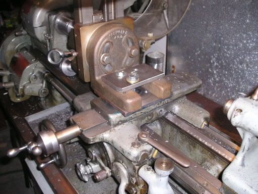

    The second pic is of my palmgren milling attachment i made the the part to mount it on the cross slide . I first cleaned up a piece of 3/8 steel then bored a hole on it and rough machined a peice of round stock to fit the hole beveled the joints and welded it up then finish machined it to match the mounting portion of the compound , and drilled holes to use the factory holes in the cross slide similar to what even has done on his milling attachment.

          Palmgren picture
          Hi Alguy, welcome!
          Like that extension behind that large cross slide dial. Did you make that? Have a similar set up (1" dial) but it is very stubby compared to yours pictured. Assume that IS a 9"" SB?

              It looks like the SB "a" model that was on the auction sunday.

                  cross slide extension
                  The lathe came with it that way . I bought the lathe from a retired machinsts daughter cause he was going in to a nursing home . She told me when her dad retired he brought the lathe home because they did away with his job. He worked as tool maker in small manufacturing co. It appears to be a mid 60's lathe some wear but not abused.
