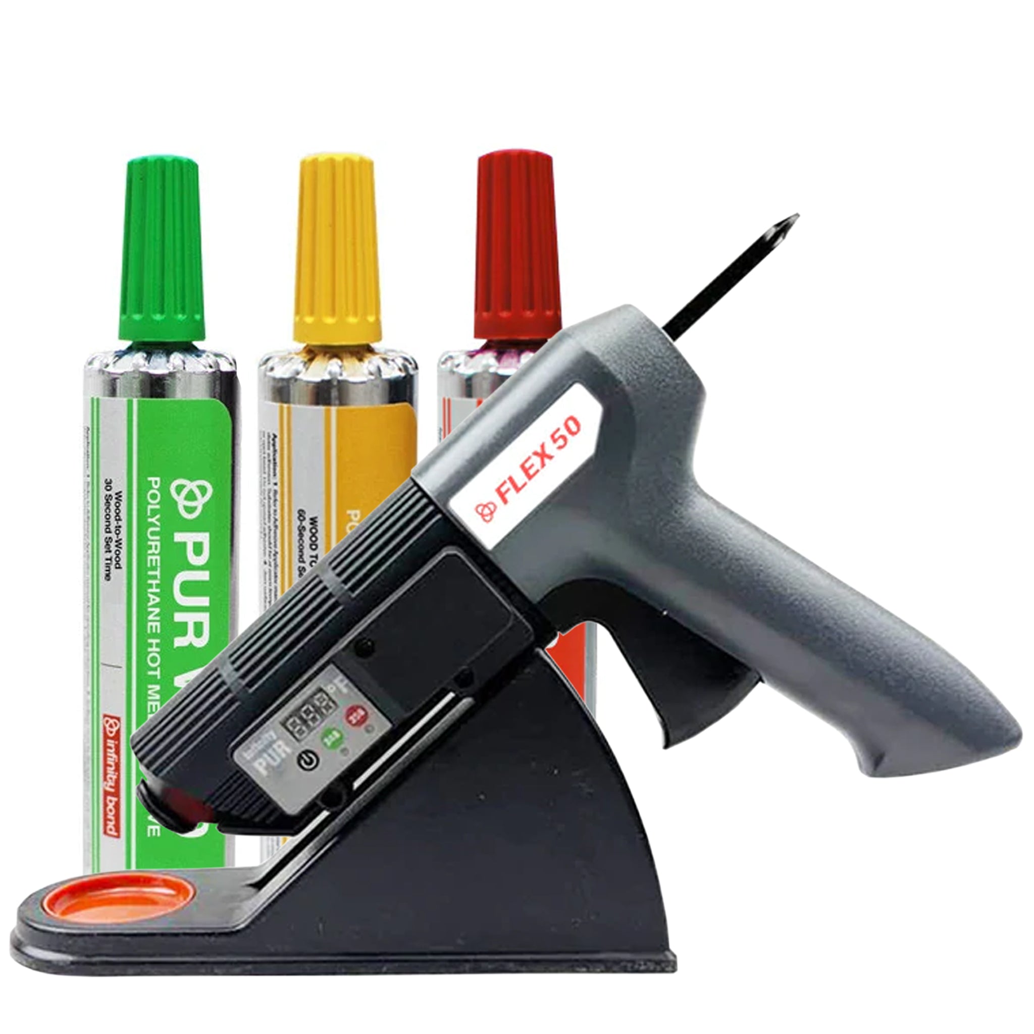

                          • #43
                            Has anyone seen the new(ish) hot melt PU adhesives, they come in a metal cartridge you stick in the gun, may well be the abrasive belt solution
                            This kit from Infinity PUR is the best way to get started with HiPUR or "hyper" glue. It includes the Infinity PUR 3000 glue gun and one of each 50 gram PUR adhesive cartridge. It is a great replacement for the discontinued Titebond HiPURformer system or Steinel PUR Glue 50 system.
                            im seriously thinking of investing
