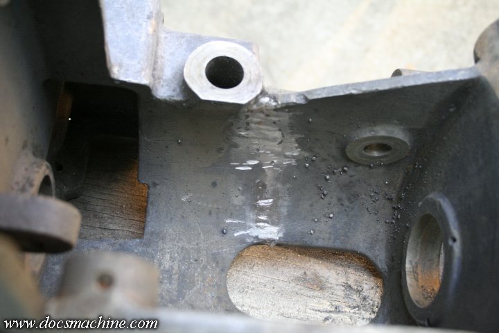

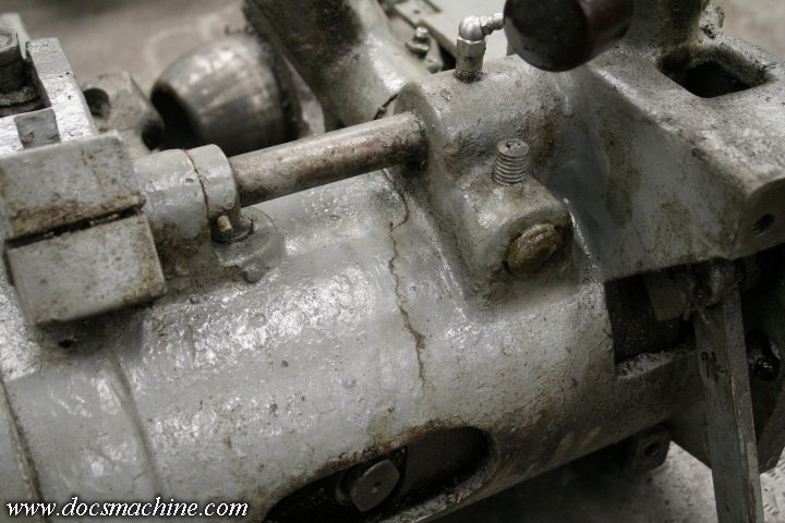

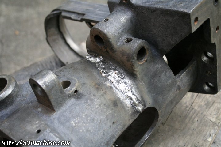

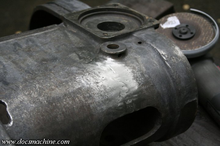

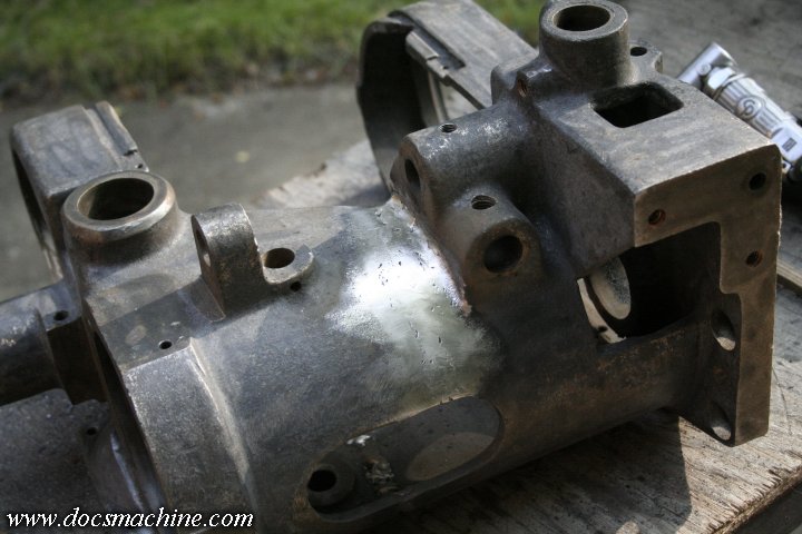

The irreplaceable collet closer casting on my '39 turret lathe:
Veed out, and welded with zero pre-heat, zero post-heat, no fluxes or fireproof blankets.
Ground smooth:
I also did the inside:
And the opposite side:
I've also used it to repair the cracked base of my big Springfield lathe as well as five of the control levers, to repair a drill press that had fallen over and been cracked, damage to the casting of an old "camelback" drill, the table legs and one support arm of a horizontal bandsaw, and a handful of others over the years.
No pre-heat, no post-heat, no insulating blankets, no fluxes, no nothing. The only 'trick' is to make short welds, and let them cool before continuing. Depending on the quality of the casting, you'll occasionally get porosity- grind it out and weld again.
These days I keep a couple pounds on hand for either day-to-day repairs or upcoming projects. Worth every penny.
