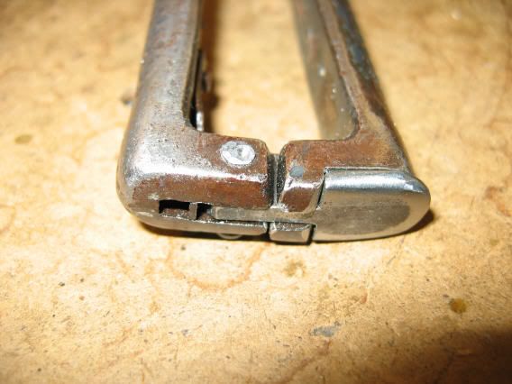

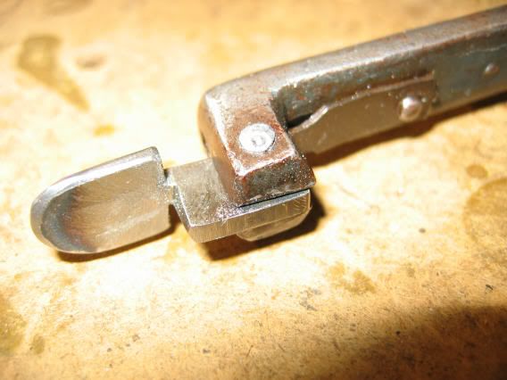

    Fix for the good pair of bypass pruners that didn't have a lock lever anymore....
    Shop work doesn't have to be something sexy for a hotrod etc to be useful and appreciated locally......
