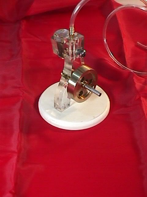

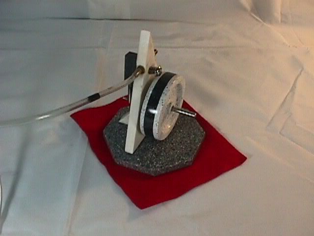

    Ok guys here are a couple of my engines nothing new to the cabin fever crowd
    The first one is a simple single action ocsilator made from corian. It is my own design insired by lucy by Ed Warren
    The second one is pattered after PM researches verticle double action ocsilator. When I showed it to Gary at PM I immediatly got a big smile. Hope you guys like it too.

    ahhh you're using that new see through aluminum! At first i thought they're not going to run on steam, but then again that corian is tough stuff , what's it like to machine? they look good Tin
      Beautiful! I really like your choice of materials. Shows some nice out of the box thinking. The clear plastic one is kind of like a “working” cut–a–way model.

        Do not think I would not try steam we use compressed air at the CF/IF show. Corian not bad to machine. Does not tend to gum up or chip out too much it is a plastic though so have to be a little carefull.

          Corian,Yes it is nice to turn at least.I do Corian pens occasionally,They don't sell well but get a lot of attention.
