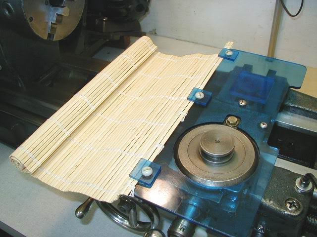

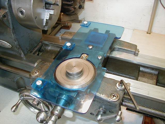

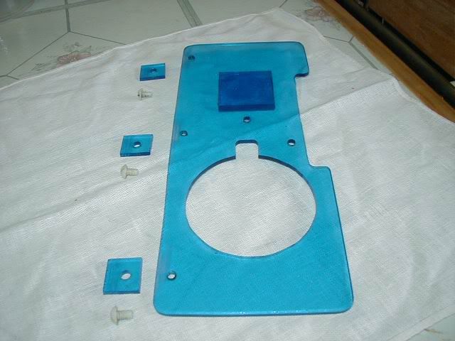

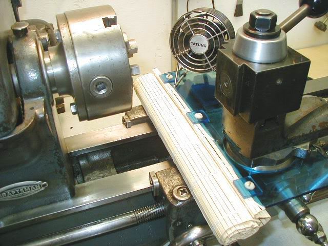

    So what I made was a removeable 1/8" plex cover for my cross-slide and apron, which keeps all chips out of the topslide lead screw. I also attached a split bamboo mat( used for making sushi, i believe) between this table top and the headstock, which can be unrollled to cover the ways and the lead screw. Since it has small slits in it, it's not perfect, but I can always cover it with a cloth to trap tiny chips. The mat can be removed easily, or rolled up out of the way if required. I can also use the plex table to support a small cooling fan, blowing straight at the workpiece, so essential if one is crazy enough to try to work to tenths on such a lathe. (The plex is blue because I had a bit of scrap lying around) :-)
    Here come my first efforts at posting pics. Here is the plex table
    Here is the table in place on the crosslide saddle/apron
    Here is the bamboo mat covering the ways and lead screw
    here is the whole thing assembled, with the mat rolled up, and the cooling fan sitting on the table top
