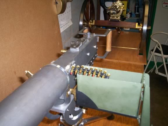

    Well, finished the prototype of the ammo can and mount for the 1917 & 1919 1/2 scale BMG's. Have to make a very few minor adjustments on the next one. The mount (now painted black) has to be bead blasted and parkerized, can has to be blasted , painted OD green, and lettered. Pardon the wet paint, dirty hands, fingerprints, etc.
    IOWOLF: 3rd pic is for you, tracers installed as per your request.

      Sharp ,Cecil , very sharp.
        Bob, not a risk at all. They all are totally legal if you can own a firearm is your state, city, etc. Over 26" in overall length so classified as a rifle. Brownings use a modified 10/22 barrel and receiver, so they are semi-auto. Gatlings fall somewhat under the same category, they have 10 barrels, 10 firing pins, etc, therefore are 10 single shot weapons if they are hand cranked, cannot be electrically or hyd. controlled. I have copy of letter from ATF on Gatling guns, and Dave Meador had copy of letter he received on model Brownings.
        The Brownings and Gatling are fully functional in 22 cal., I put .17 ammo in for the visual effect.
