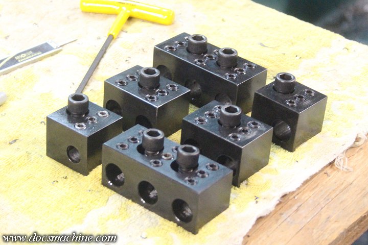

    Several months ago, I picked up an Omniturn CNC lathe, which uses gang tooling. The purchase of the machine itself took pretty much all my spare funding- and then some - so I've been having to scrape together what I can for tooling.
    I only got two 3-hole tool blocks along with it. Blocks are available from the factory, but the small handful I wanted was going to knock on the door of $900. And that is, unfortunately, just too rich for my blood right now.
    So I hit up my local metal supplier for some 1.375" square stock, cut more or less to length...
    Did a BUNCH of drilling, boring and tapping...
    And, after a few hours stolen here and there, had a shiny new array of tool blocks, hopefully enough to keep the thing in operation for the time being.
    I still need to finish the T-nuts, and I may go buy a couple bottles of cold gun-blue and give 'em a dip, just for giggles.
    Doc.

                Aaaand done!
                Found I still had a half bottle of Casey's gun blue, so I degreased the blocks as best I could (not well enough in some cases ) and mopped 'em up with a flux brush.
                Also found the bolts I needed at the local Fastenal, and got most of the T-nuts drilled. (Still need to do the two doubles.) So count this little project finished!

                            So.... this is sort of like the CNC equivalent of a manual turret lathe?
                            Any chance of some pictures of the turning tools used with this unit? I'm guessing that even the OD cutting tools look like mirror image boring bars. Is that the case?
                            Chilliwack BC, Canada
                              Originally posted by old mart View Post
                              I see, so right and lefthanded boring bars would be suitable candidates for tools.
                              -That's basically the recommended tool.
                              There are, of course, several ways to skin that particular cat. The machine, for example, is perfectly happy running in 'reverse', so you could easily use a standard right-hand boring bar, either above the part or below. There's also dovetail tool posts sort of like a typical Aloris (though without the QC handle) that take similar tool blocks, that can in turn hold standard square-shank tooling.
                              But ideally, having the tools out on a bar is, in my opinion, the most efficient on space, keeping slide travel times down, and are easiest to set up. (Most are "plug and play".)
                              Did you tap with a tapping head, if so what make and model?
                              -No head, by hand. Certainly wished I had a tapping head, though.
                              -Certainly! My Omniturn Video.
                              Doc.
