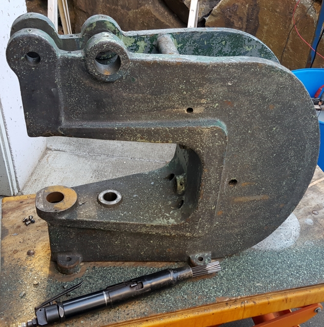

                    Where I worked we called those "needle guns". I think they are best at removing multiple layers of old paint. They will remove a lot of a heavy rust buildup, but won't take the piece all the way to shiny. For an old box & pan brake, I'd pull all the fingers and related fasteners and derust those using evaporust or EDM or bead blasting. Your needle scaler would work pretty well on the remaining part of the machine.
                    I used my needle gun on an old turret punch recently:
                    I also own an IR model (made in Taiwan) and value it highly.
