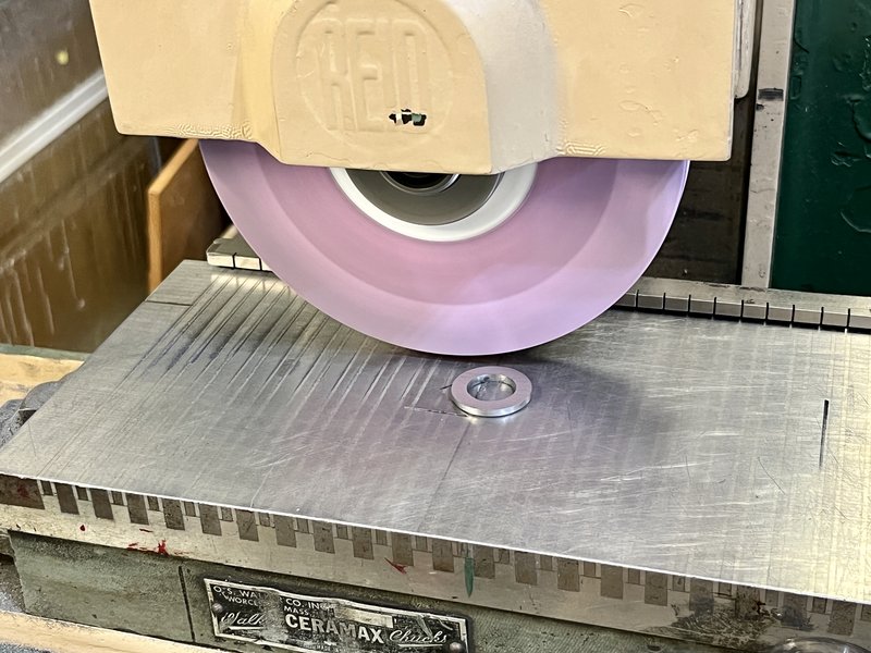

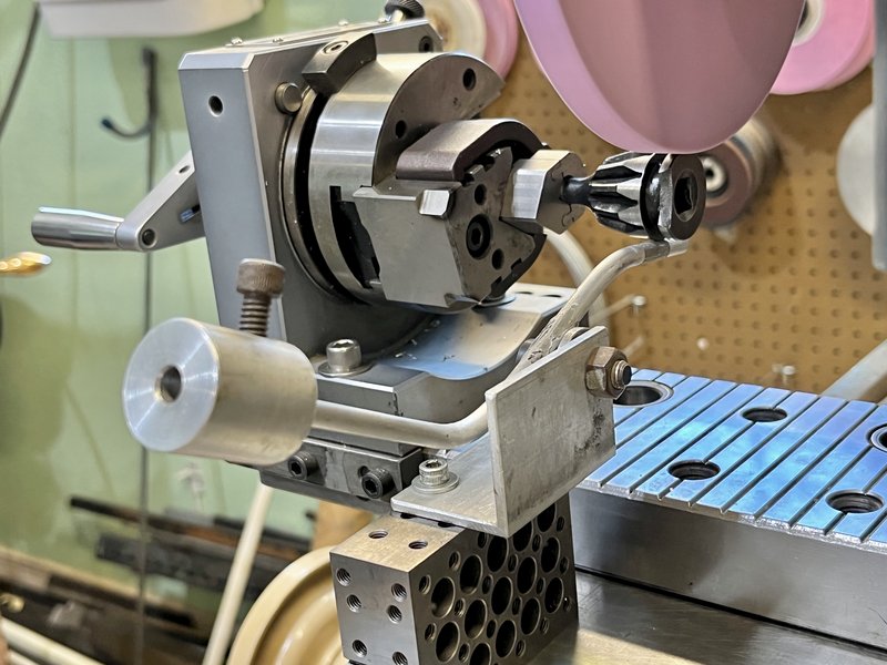

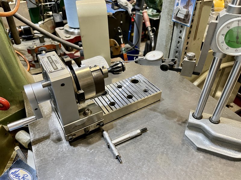

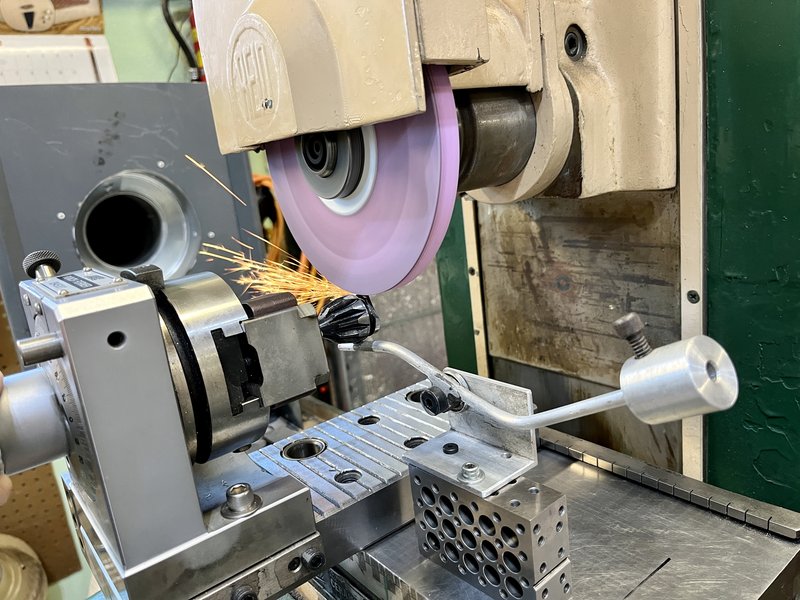

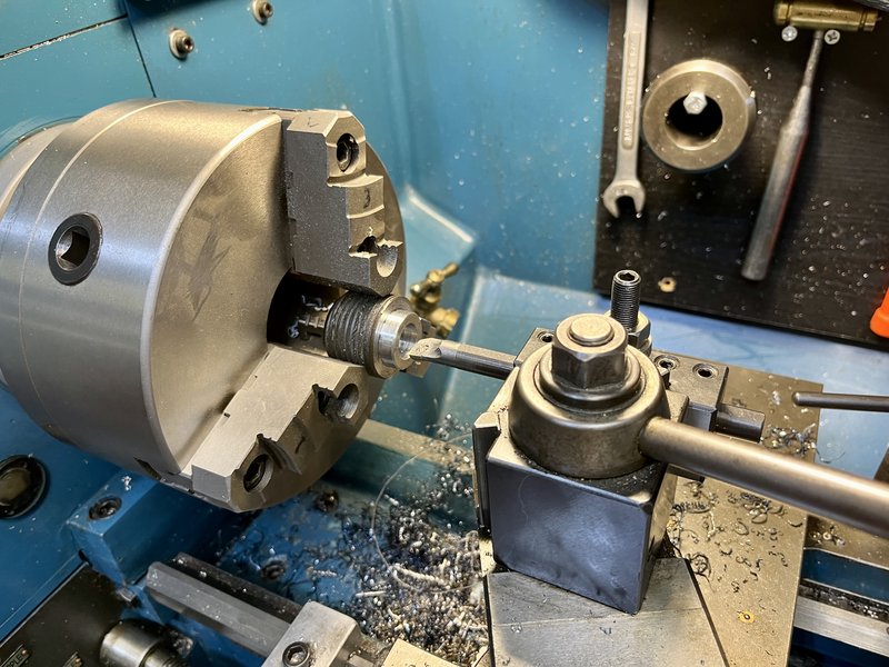

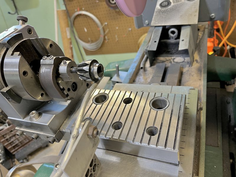

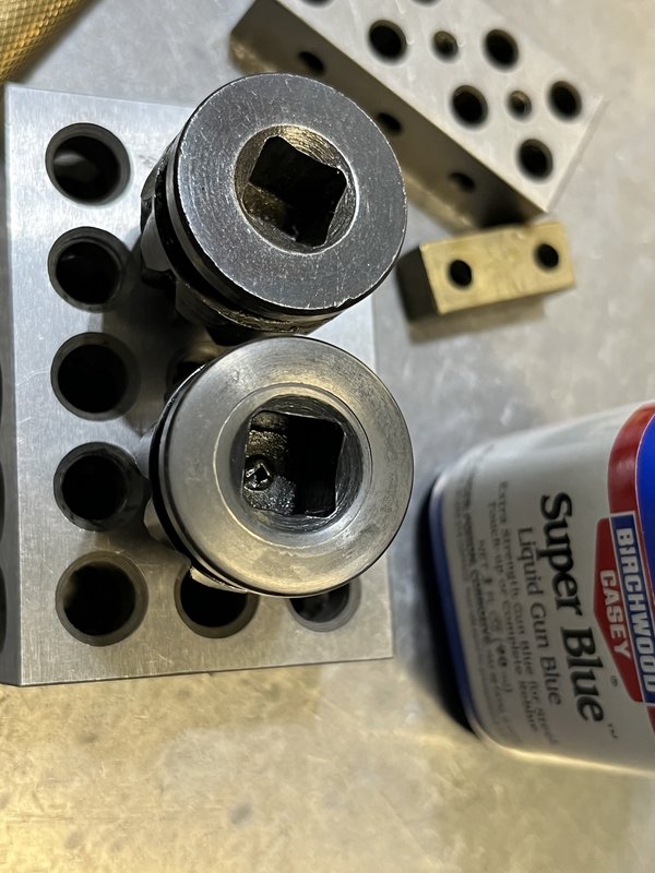

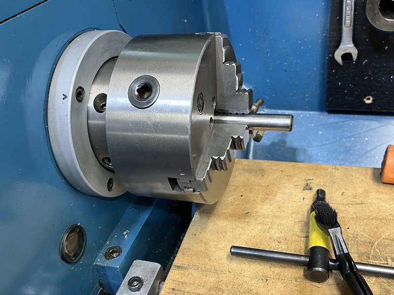

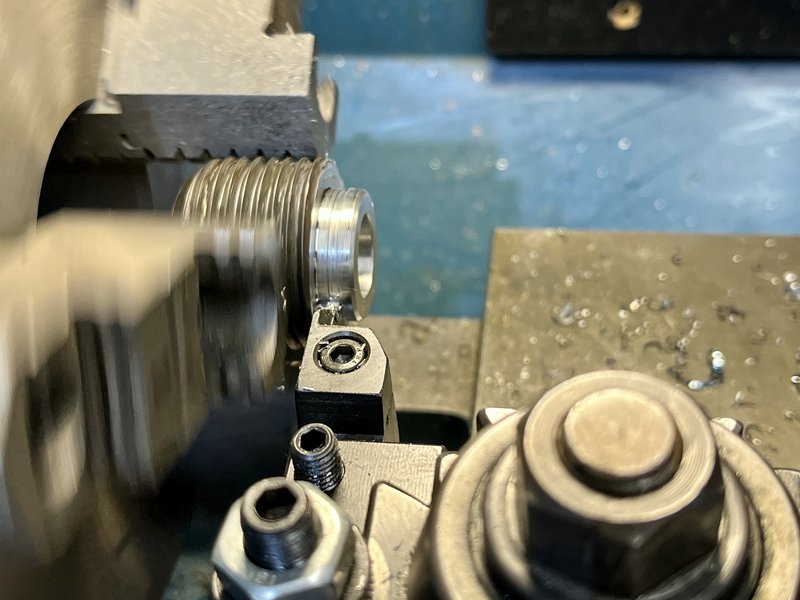

    I guess I got a little heavy handed with my Chuck key and cracked the outer boss on one of the key gears on the ChiCom 6” 3 jaw that came on my ENCO 13x40. It’s always been more accurate than the 8” 3 jaw I have so I need it to be there when the need arises. It would jam against the retaining pin that holds it in place when the chipped out portion lined up that way.
    So today I fixed it and actually did some pics along the way…
    Back in business…
    Illigitimi non Carborundum 😎

        I would have thought that a nice force fit would have been adequate.
          Nice fix!
          I sort of doubt that this was your fault though. I'm thinking there was a partial crack, inclusion or other defect in the steel. After all the original square socket was still intact out of all of that.

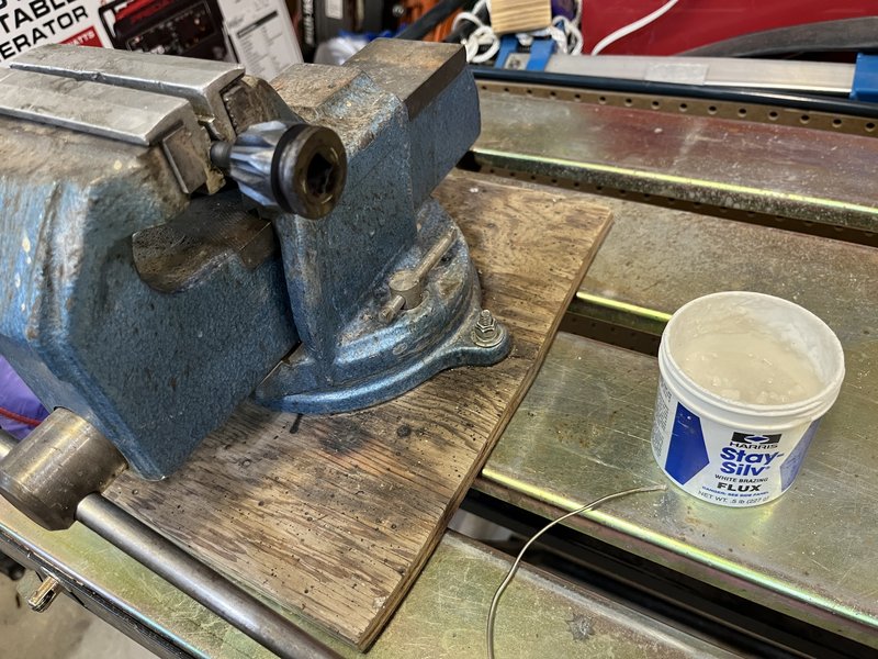

              My very first day of my very first machine shop job I was taught to silver solder and learned to love it.
              I think I silver soldered something every shift for the two years I had that job.
              It’s a very rewarding skill that has ingrained itself into my psyche and become almost second nature in my planning out stuff like this.
              It’s also very effective at keeping things from hitting me in the face at 30 feet per second when the chuck is spinning at 1150 rpm.
              I don’t do adequate.
