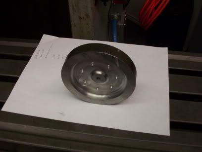

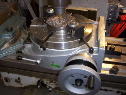

    Results from playing with the new RT. I am building a finger engine for a 'filler' projectl. I had to break down the set up to do another quick project. I hope to get back on it soon to wrap it up.
    In case someone is thinking it, a lathe would by far be the better choice for this application, but I can't seen to locate one in my shop!

      Is that a Phase II? If so do the table locks really lock?

        Did you do the recess on the mill too? Great work!

          I have an 8" PII RT and have been quite happy with it. The table locks seem to hold just fine. After I bought it, I also got the tailstock and dividing plate set, but have never needed either (so far!). Have used the table quite a bit on a couple of model engine projects.
          I did have a problem: was milling a round-bottom slot with a ball-end mill and the thing was chattering a bit, causing back-and-forth vibration in the table. "Something" caused the thing to gall up, and I had to disassemble the table to clean up the boogers. Getting it apart was easy, once I figured out that the table locks had to come apart first.

                  Yes, it is a 10" Phase II table. The locks seem to hold, though I haven't really 'loaded' it yet. It is real smooth, and there is very little backlash. In my opinion, it is a good table for the money, and it should serve me well for the things I do.
                  CCWKen, I did the recess with a 1/2" end mill, and then used a 3/8" ball end mill to finish the recess. Afterward, I spot drilled seven places to bore holes into it at a later time.
                  Unfortunately, I was volunteered (got to love that!) to build two small two-wheeled dollys for my son's school, so I have had to slide the flywheel back in line for a bit. Oh well, I know the kids will have fun with them!

                          Good accessories for the rotary are a three jaw chuck, sub extension plate with lots of threaded holes, a threaded plug to press fit under the table for center clamping, and a system of centering pins to locate from the center hole of the table.
                          Below is machining the trunions on a mini. Swivel gun on the rotary table with a three jaw chuck.

                            Kap, what I can see of it..that is one nice set-up. Wish you had a bigger pic.
