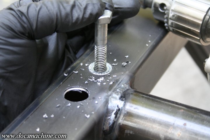

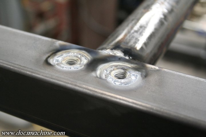

          Several years ago, I stole an idea from an issue of Street Rodder magazine, that covers this.
          All you need is a flange nut, a step drill and a TIG welder. Drill the hole to the correct clearance size, and then partway through with the right size to accept the rim of the nut's flange.
          TIG around the OD, which may not even need filler in many cases...
          Grind it smooth, and you have nice, solid threads to which to bolt things.

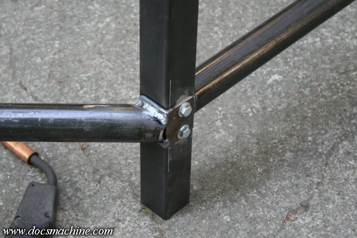

            In situations where I need to bolt to a square tube, it's usually quick and dirty will do. And given that tack welds are almost always as much weld as is needed, I would do this:
            Click image for larger version  Name:	nut.jpg Views:	0 Size:	37.9 KB ID:	2049131
            Not so good for really thin walled tube, but I don't use that stuff much.
