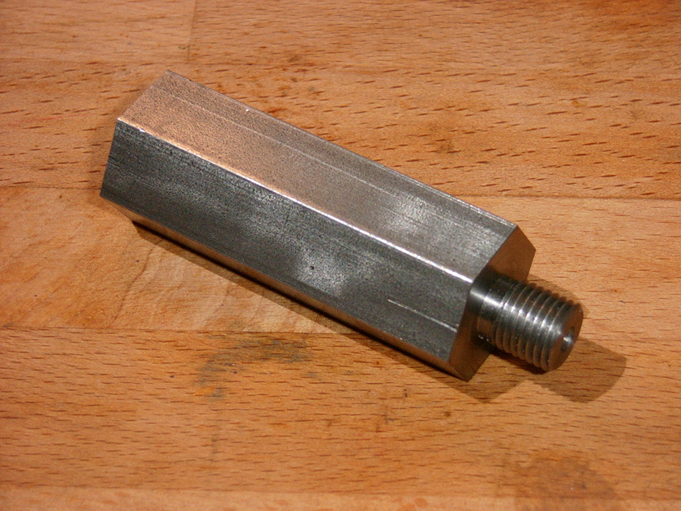

So I wacked off a chunk of hex stock and turned down a .375 end. I swapped gears to get 24 tpi, and threaded my turned end:
