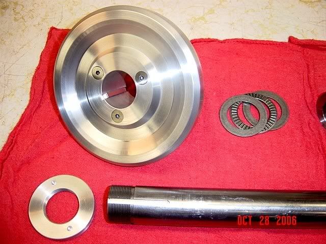

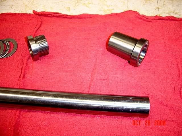

    A few weeks ago there were several threads floating around regarding collet closers. I took some time off from the mill restoration to complete mine for a Grizzly G4003 12x36. The 5MT to 5C adapter was purchased from Grizzly, Torrington thrust bearing and washers purchased locally for $10, everything else made by me.
    Enjoy, Cadwiz (Clinton, La)

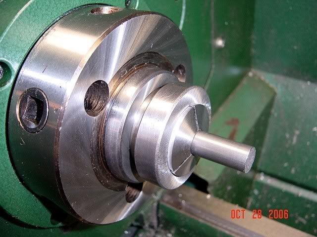

          Nice job! What kind of runout did you end up with?
            Tim, the three reference articles I researched all used needle thrust bearings. For the cost I figured it couldn't hurt. Seems to give a nice smooth feel when tightening the drawbar.
            Sidegrinder, I just measured runout. Surprisingly it looks like around 0.0005" or less. My new indicator was just barely moving between the smallest division marks. Either it's crap or I did a fairly good job on the machining. Not that I really need the accuracy, it's just that the 6" and 8" chucks were getting in the way for small parts machining. A nice new addition to the tool selection at hand.

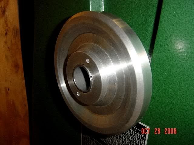

                Here's another pic of the assembled closer off the lathe:

                  Cadwiz...I keep looking at this thing and I'm missing something. The thin ring...what are the two divots for? How is it held onto the assembly?
                  It must be covering the main part with the three flat head screws but I'm not really seeing the purpose of it or (again) how it is held on. Funny what a lack of sleep will do...
                  Thanks!
                  Russ
                    Torker, the retaining ring and outboard end of the drawbar are threaded 1-3/8x18 (the threads in the ring don't really show up in the photo). The divots were drilled so I can use a face spanner if necessary to remove. Yesterday's testing has so far proven that the retaining ring keeps the handle/hub snug as the backside recess bears against the thrust washer and the other washer bears against the spindle adapter. So far I haven't needed the spanner, but I put the holes there just in case. Being aluminum I didn't want to bugger it up if it becomes cranky. I broached the hub (first time I've done that!) and milled the slot for the key to act as a driver to drive the drawbar so it will tighten into the collet. When I was researching how to do this I kept asking myself the same thing: How does it stay on? The answer seems to be a friction fit from the 5C taper. I guess this is correct, it seems to work properly. I pretty much used Don Kinzer's design for this project:
                    http://www.kinzers.com/don/MachineTools/collet_closer/
                    The only changes were that I made a 2-piece handle/hub assembly instead of machining a solid chuck of 6" aluminum and I threaded the spindle adapter instead of using a slip fit. As such, the three flathead socket screws holding the hub to the handle prevented me from counterboring a recess in the handle for the retaining ring to fit in.

                          Nice work! Are you thinking of knurling the OD of the handwheel? I had to do that on the two factory made closers at work.A little coolant and the plain ones get slick.
                            My knurling tool is too small for knurling. One of the reference articles I found on the dropbox showed grooves made with a ball endmill. I figured I'd give it a chance without the grooves first since I don't use coolant. If need be I'll put a series of grooves around the handle perimeter.
                            Cadwiz
                              What about cutting some 'spokes' in the wheel to help with gripping? less likely to cause an injury than knurling or grooves on the periphery, IMO.
